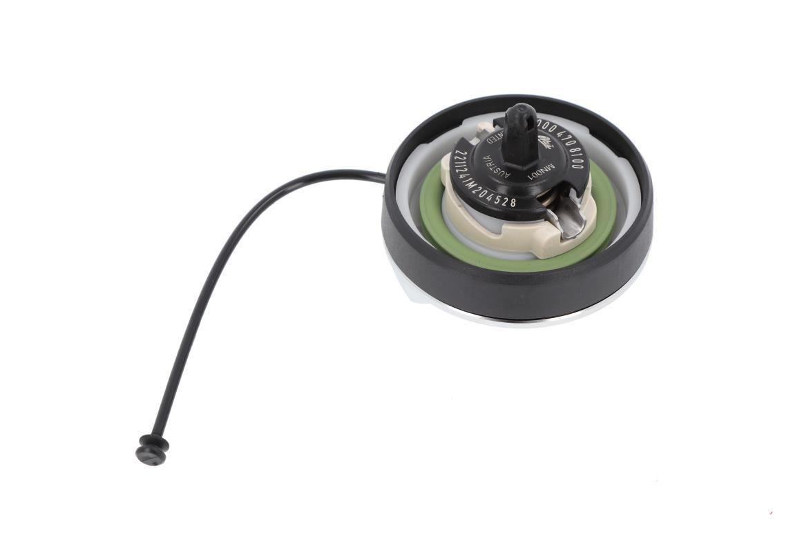

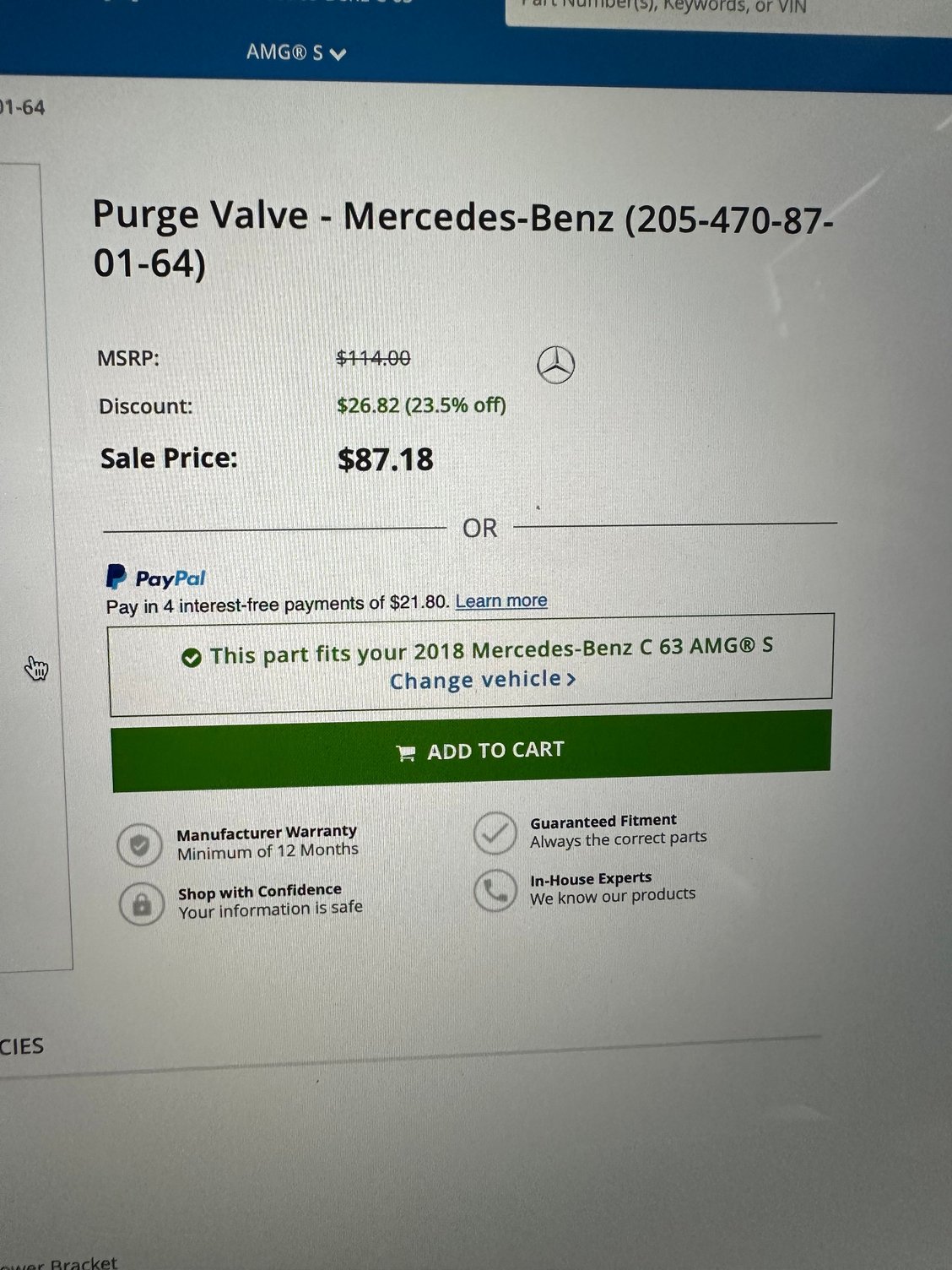

Update: solved the gas cap light, rough idle after filling gas and check engine light.
I stopped by the dealer to get a new purge valve. replaced the purge valve and inspected the old one. It was very dirty on the inside of the tube, some corrosion, and what look like sand or dust. Engine a lot more responsive, power feels like before when I first got pure 900 turbos. Idle smooth asf. Ticking sound is completely gone. No more loose gas cap light.

Koi could you post the part numbers up for the PCV's you've changed I want to change mine too. They're just tapping away like an old Mitsubishi
Old Apr 29, 2023 | 12:42 AM
  #33
Jimmy_c63s's Avatar
Joined: Sep 2016
Posts: 1,718
Likes: 608
From: Australia
A2054708701
Source Nemiga EPC

1. Purge valve started getting loud a few thousand miles back (ticking noise on driver side for right hand drive cars)
2. Loose gas cap light randomly coming on and off
3. After a week or 2. Car would start rough, misfiring plus check engine light. that along with surging rpm on idle and drive
some other things i’ve noticed is the power. it feels like I lost 200hp from my pure 900

The part number I posted above is the correct one you got aye?

I don’t have any exact measurements. But the interesting thing I noticed was that the stock cap had no internal conical nozzle that the 55 cap has. Instead the stock cap is flat on the inside. Also the 55 cap says “vented” which the stock one doesn’t (or maybe it does and I didn’t notice it)…so idk what to think of that.
Always wondered why they look different.
Edition 55 inside with a conical nozzle
I got my caps from ECS tuning. Haven’t driven long enough or had my cars dirty/washed enough to notice a difference yet.
correct
