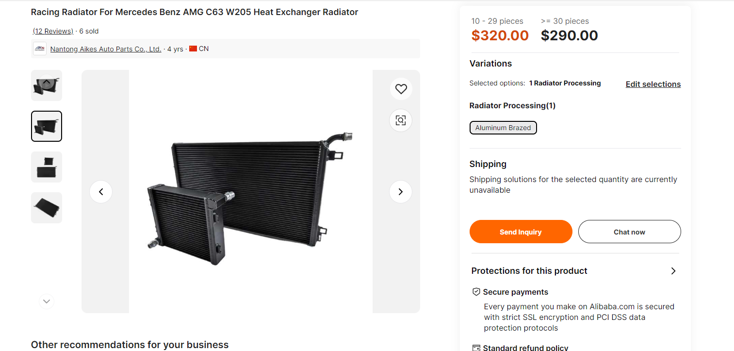

Hate to revive an old thread, but see the CTS Turbo Radiator costing way less than any other brand, anyone have any positive or negative experience with this product? I am wondering if the CTS, CSF, and Modalworks products essentially function the same and have the same build quality.

probably because it's from alibaba, not saying its bad ofc, I might order one myself. A friend of mine has it installed on his C63s (we live in gcc and the weather gets really hot in summer) and he did notice his temps going down by a bit, nothing too crazy.
