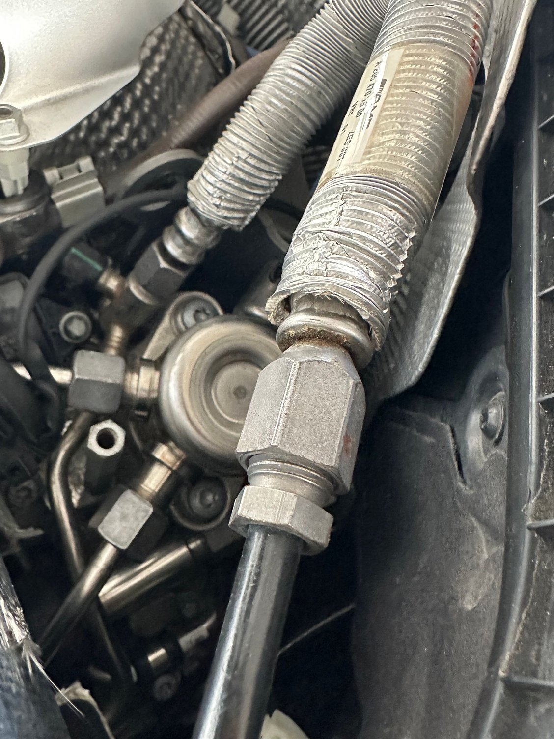

I had the same issues as you on my last c63s. For me replacing my purge valves solved the issue. They were also very loud so I resolved two things with one part. Hope this helps.

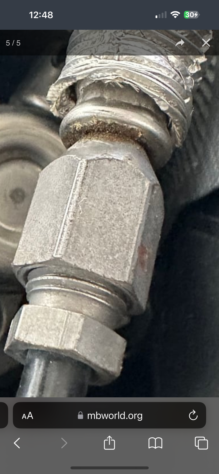

i did change my purge valve. I think i found the cause. Looks like a small leak over time. I tightened that part a little and it help a lot with the problem. Do you know the name of this part?
Sorry which part are you referring to? The connection closest to the camera? There’s alot of leakable connections in the photo haha.

This part, closest to the photo. Btw, do you know how many vacuum valves are there in this engine?
this part
