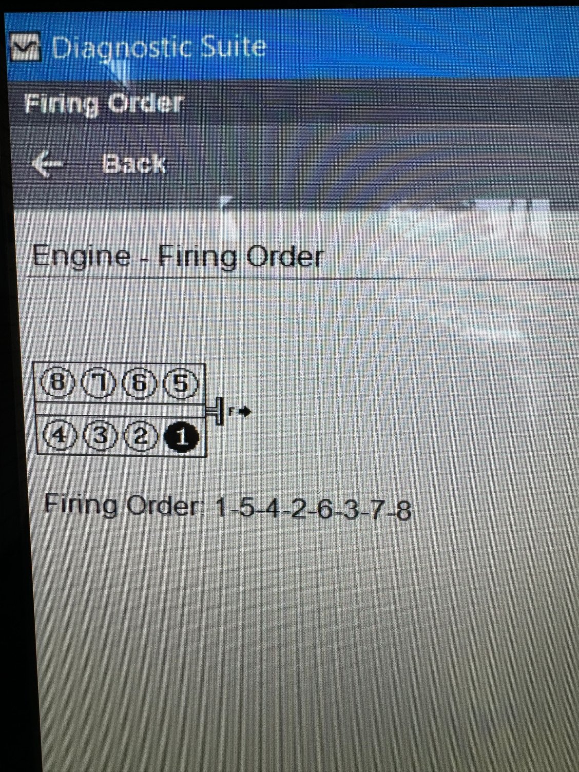

Alright after reading some threads they screwed me up..
if I’m sitting in the car. Which bank is which??
primarily looking for bank 2*
multiple threads say either or and I’m confused now.

Bank 2 is on the passenger side
