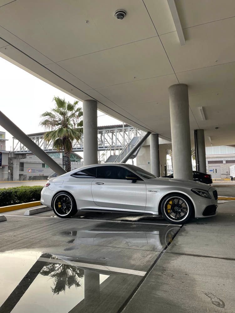

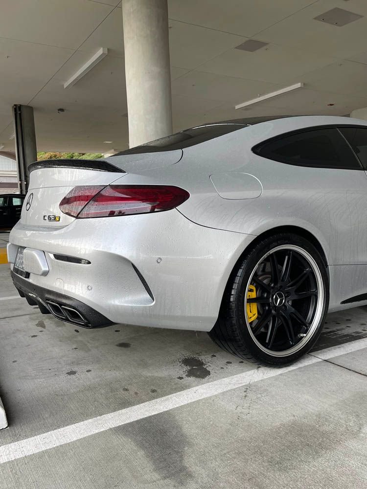

Got the OEM Springs put back on yesterday - I still have some rubber left so I'm currently running 255/35/30F & 295/30/20R with 20MM Spacer Front & 15MM Spacer Rear.
To my surprise the 15mm in the rear fit really flush with no poke on the 295's. However I think the front needs a 15mm since there is just a tad of poke with the 255's
Didn't pull the trigger on the new tires since I'd say Ive got 30% left front and rear. After that I'll be doing the 275/305 setup.
Let me know your thoughts!

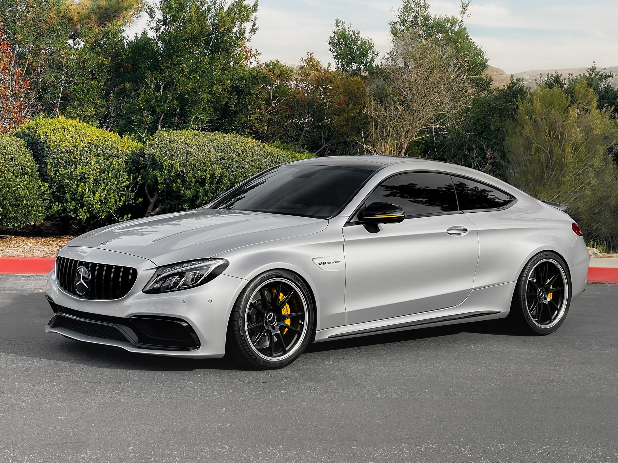

Old Feb 8, 2024 | 04:40 PM
seabiscuit's Avatar
Joined: Nov 2023
Posts: 65
Likes: 10
From: Tampa, FL
2020 C63S Sedan
Looks dope, personal preference here- blacked out sidewall on the rim would look sick.
Main reason I'm commenting- yours is the Iridium color, correct?
I can't tell, but is your front grill blacked out? If so, can you send a pic of it? lol. Same color and I want to black mine out, but haven't seen any with blacked out front. Lol, gracias partna-

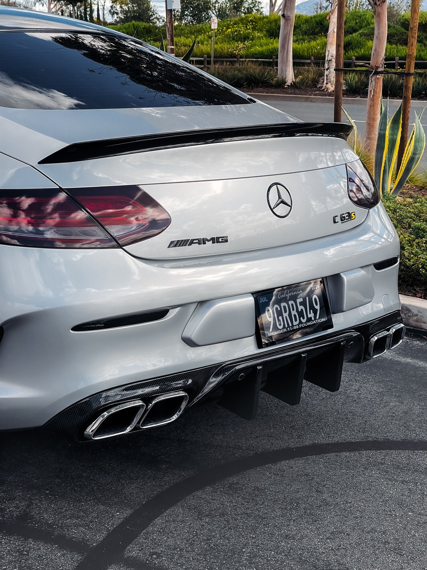

I actually had a 2019 C63 before this one but sold it after 3 years since it was so quiet and that one I actually blacked out the lip but didn't look all that great imo - just blended in with the tire and kind of looked a little cheap imo but obviously personal preference.
The reason I chose Iridium Silver is because I wanted to do a Black / Silver / Yellow look. I would paint them all black if the car was not silver but that was the reason I wanted silver in the first place.
I also just updated the tips and diffuser with the OEM larger facelifted ones. I went with Silver tips too since it matches the wheel lip and color of the car + the major reason is so you can actually see them lol - never liked how the black just got lost in the diffuser personally.
As far as the grille goes I also swapped it out with a Gloss Black facelifted one with new Emblem with black surourd. Made the biggest difference. It was the first thing I did.
