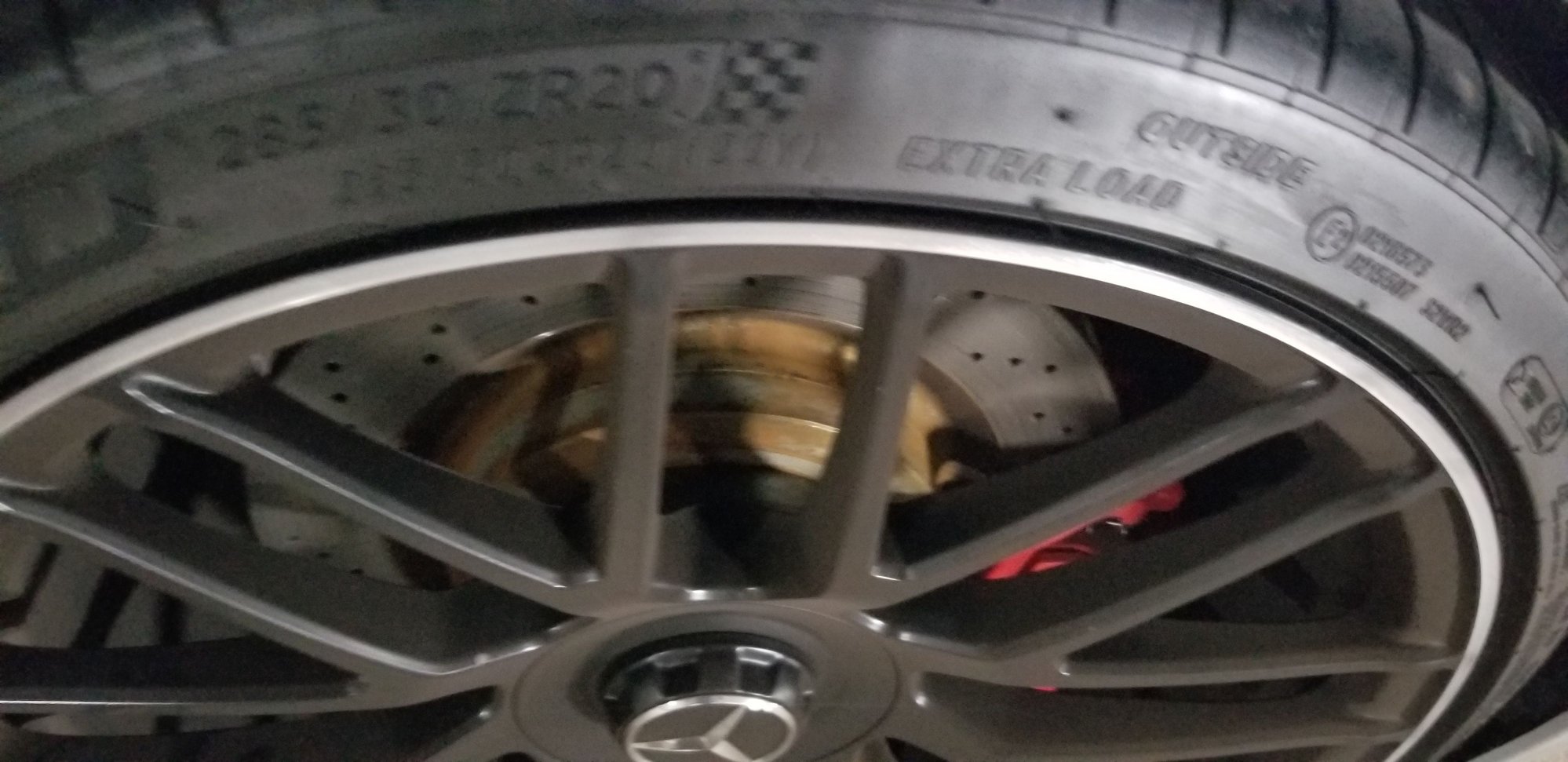

A few months back I purchased from FCP euro a rear brake kit consisting of Zimmermann zinc coated rotor with original stock MB brake pads. The original MB rear rotors hubs/hats rust out especially on salted roads and are unsightly on a beautiful. ( see photos) . I selected the standard shopping and delivery was in 2-3 days in NYC area. I drove to an experienced Indy, he put the car on the lift and only few hours later it was done. I waited in the area and convenient for sure. The labor was between if I can remember was between $ 275 and $350.
You can see the Zimmermann rear rotors hubs/hats have held up against the current salted roads compared to the rusted mb rear rotor hub/hats. And with the original mb brake pads along with the quality Zimmermann rotors I feel confident.
Also last year I replaced the front brake kits through FCP euro with Brembo rotors and original stock mb brake pads. The indy stated that
these Brembo rotors are excellent.
