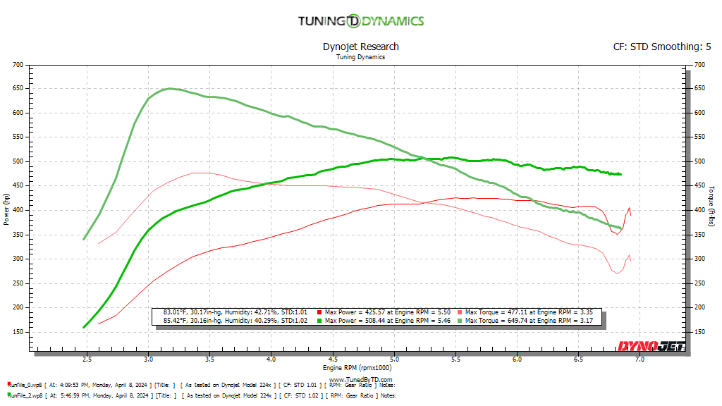

I just got a stage 2 tune ECU, TCU, and CPC tune, with air intake and titanium catless downpipes for 93 octane gas. On the dyno image are the results of stock vs tuned run. It is referencing WHP of course. I just expect to maybe hit 570 WHP, which if you add 20%, would be 670 crank HP. Thats what I expected but how do the results look?

I would have expected higher hp numbers with the tune and downpipes as well, but it looks like you picked up 83 hp and 172 ft-lbs to the tires with the upgrades. Not sure how that compares to other tunes but it seems pretty solid. Not sure how useful that giant spike of torque at 3k RPM is going to be, though.

Your results are a bit on the low side but that may be because you're used to seeing PFL tune results. Facelift cars always tune lower due the their smaller turbos and manifolds etc.
Looking at the graph that tune is a bit whack with the huge torque spike at 3000rpm too. How does the car drive with that torque explosion at 3000rpm then the drop off... are you happy with it?

Dyno numbers do not really mean anything. Many different types of dynos and loading settings. Do a Dragy run and that will let you know how the car is putting the power down in the real world
