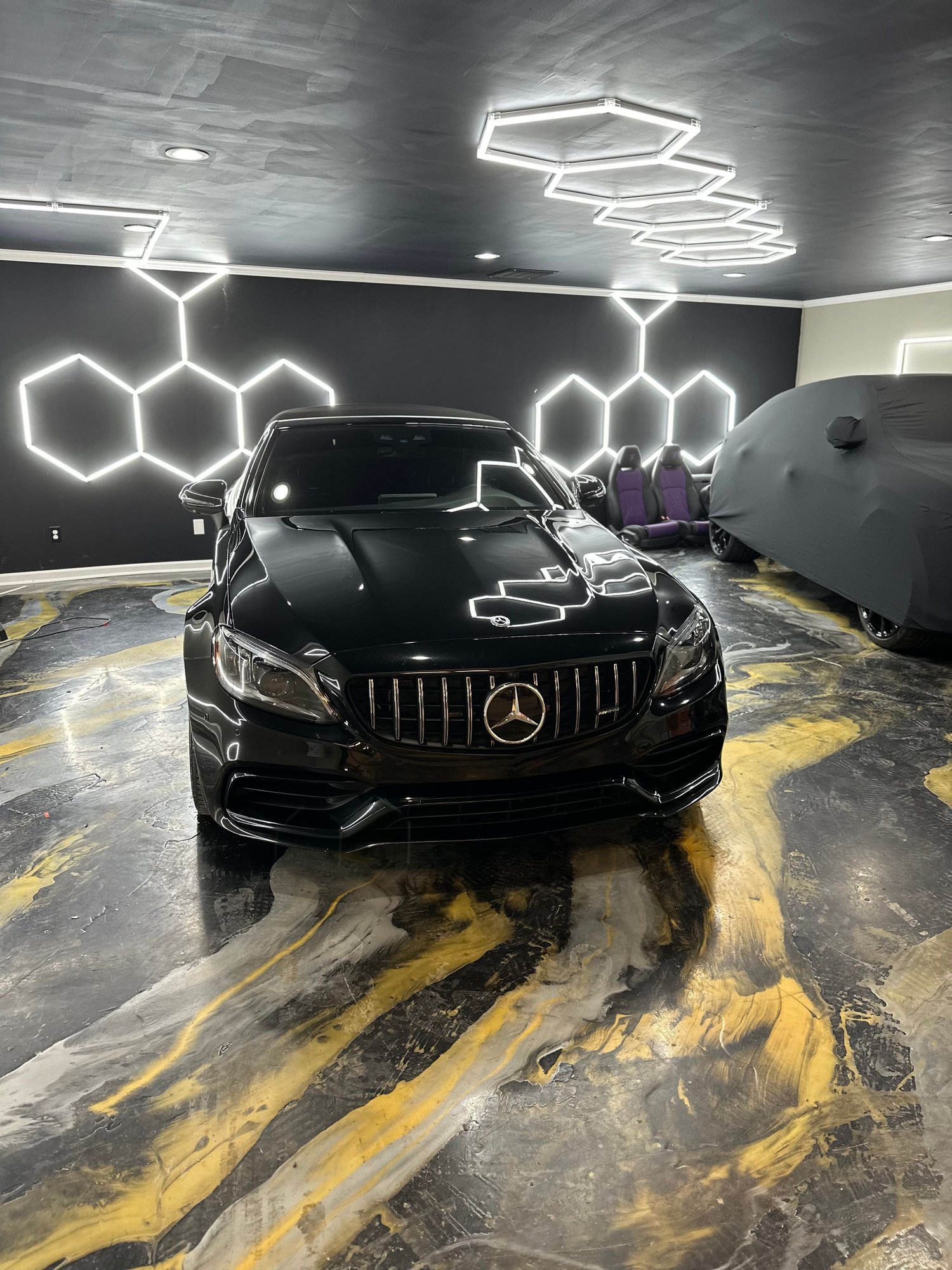

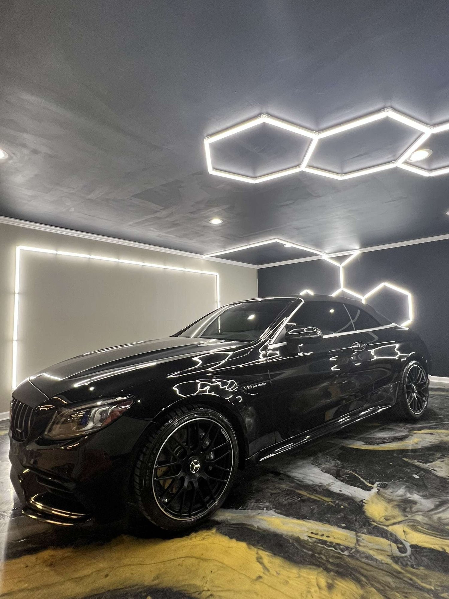

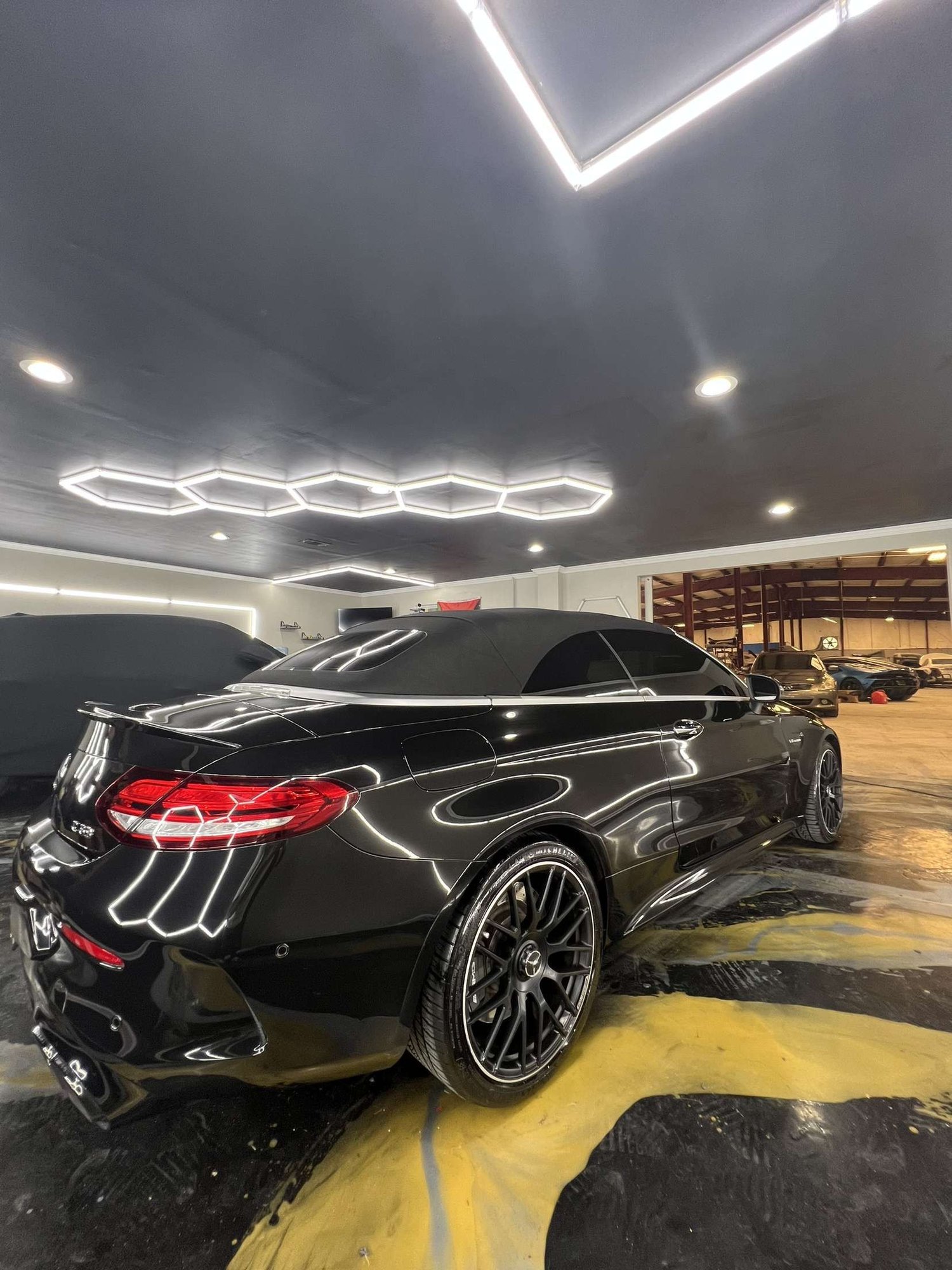

Hello! I currently just bought a 2020 c63 convertible and I’m loving the car. Only thing is, i feel as if the car wants to go faster. Trying to figure out on how to properly get it where i want it to be and have been laying out a few things but i definitely need some help!
