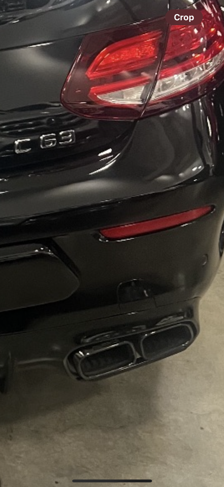

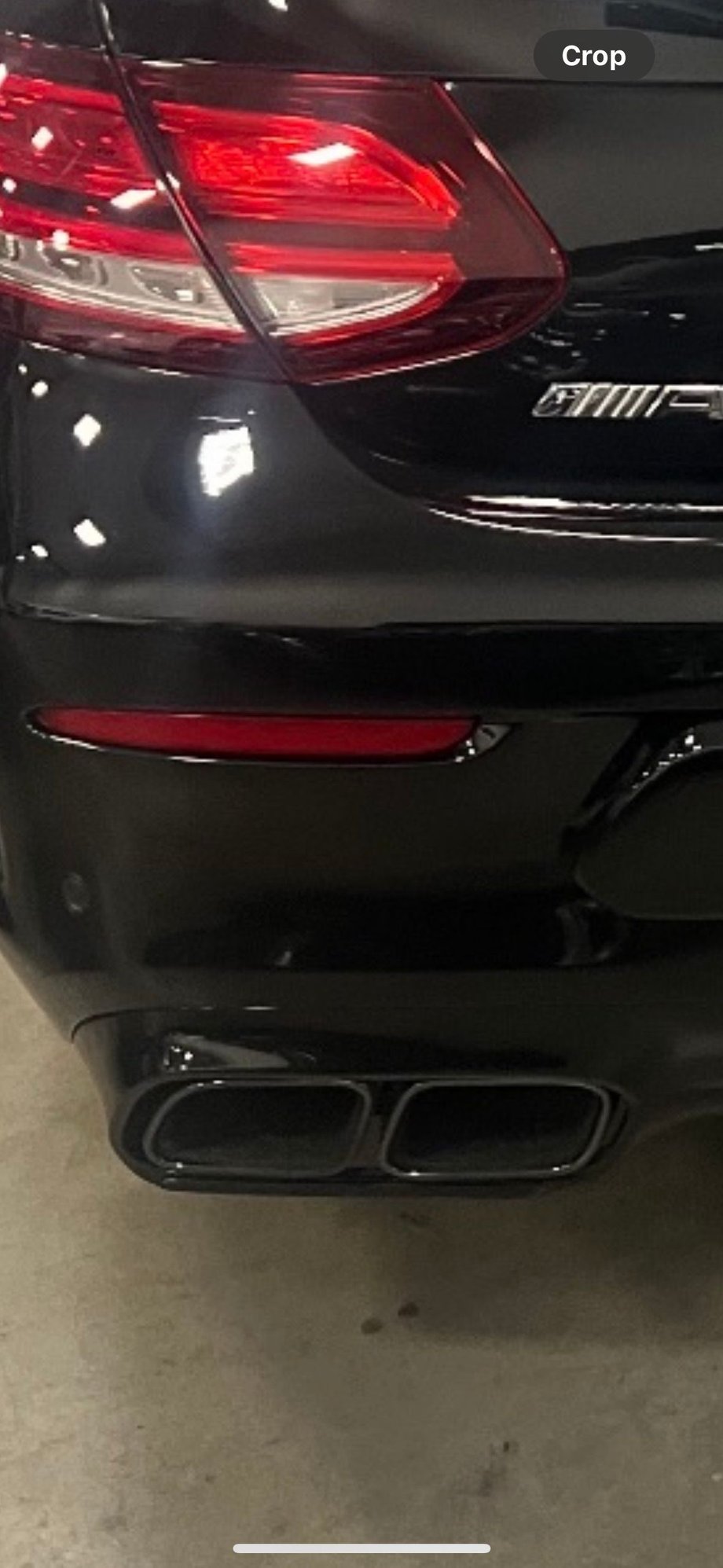

Just bought this car and realized the exhaust tips on the right side are not sitting flush with the diffuser. Anyone run into this issue and know how to fix? If not, plan to go into my local body shop and ask.

Id imagine they attach the same way as the pre face lift cars, if so it's a couple of torx screws. You should be able to loosen them up and adjust pretty easily.

Both sides (left and right) of the tips seem a bit off. They typically stick out a little more where you can see the AMG logo on the tips if you look directly down on it, but yeah like what is said above, just a couple screws which you can get to from underneath, don't even need to jack the car up. Probably takes 5 minutes to do. I'd imagine the previous owner had exhaust work done or the car was in an accident where the bumper was removed since those tips shouldn't really ever move

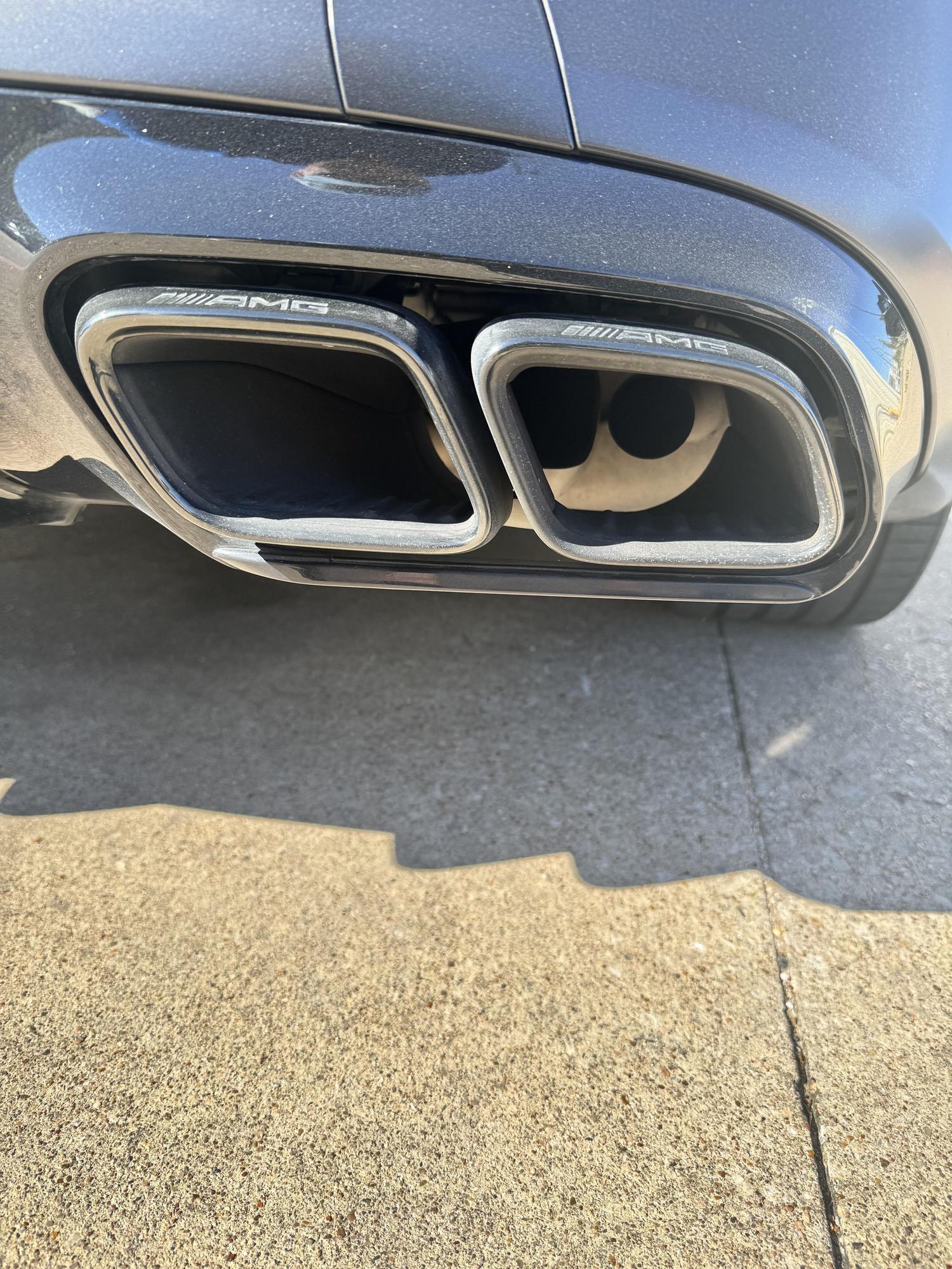

Both sides are off. Looks like yours doesn't have the aero package, so you don't have to first remove the splitter to get to them. As said, they are just screwed into the diffuser. Definitely curious how they ended up like that. They come in two colors, silver and black. The latter is part of the Night Package, so maybe the previous owner installed the black ones and did a terrible job. Pic above is from a PFL. The FL tips are larger, but it's correct that they stick out a bit to reveal the AMG logo. Here's a pic of mine showing both sides. I've got the aero package.

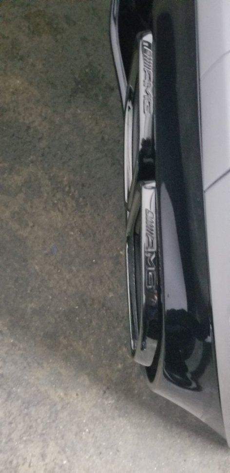

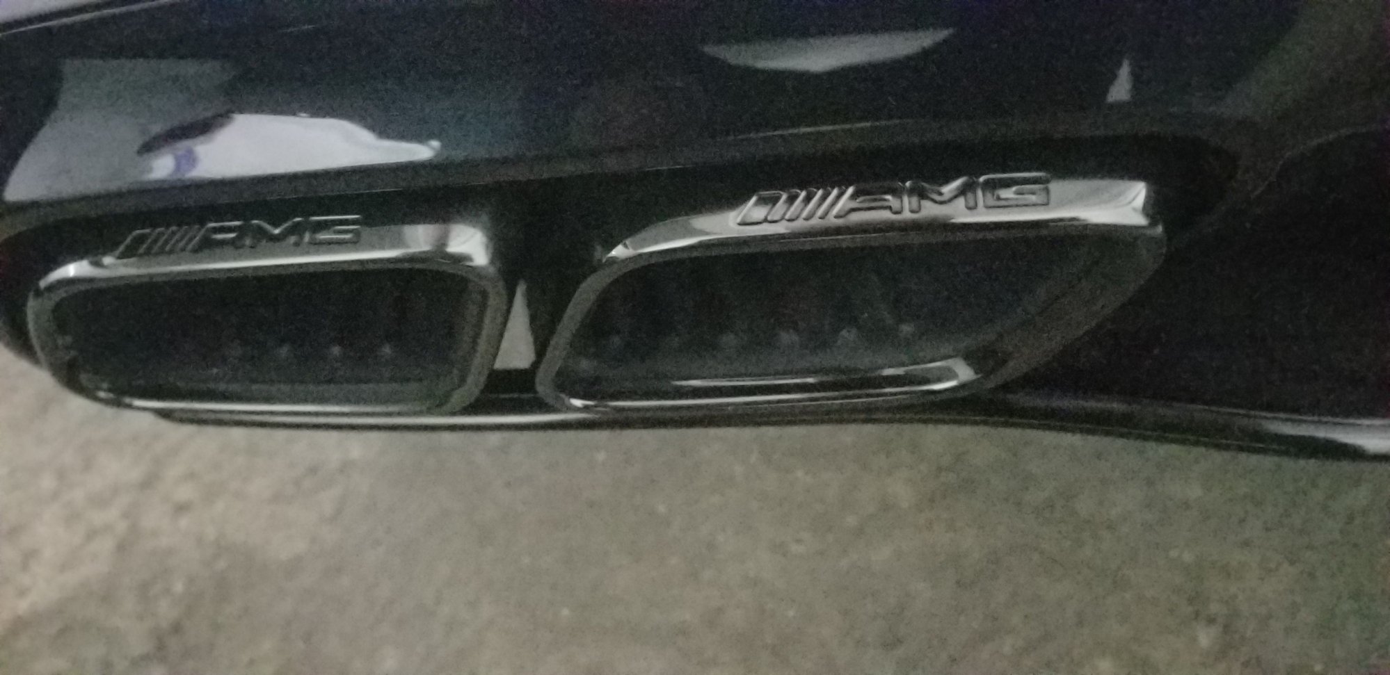

The photos below just taken from my 2019 C63s coupe. Photos taken from both sides. Original owner. I tried to measure exactly how far they should stick out but the dimensions change from each position.
