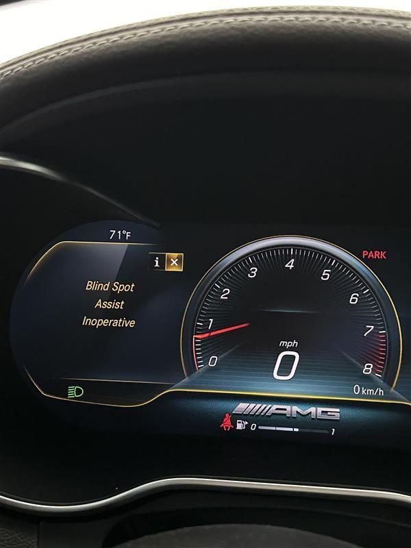

Within 2-3 hours of purchasing this car, I ended up with a Blind Spot Assist Inoperative and Check Engine light... Hopefully this is not foreshadowing how ownership is gonna be.

Check the blind spot radars, give them a bit of a wipe with a wet chamois. As for the engine light, did you recently fill gas? A lot of us have had it happen due to a loose gas cap.

Buy a Foxwell NT510 for the immediate future.
The blind spot thing happens sometimes, it's sensors, column module, low battery, sometimes it's just cold, cars dirty, just went thru the car wash, etc. Not making excuses for Mercedes but they're a bit wonky sometimes when it comes to that exact module.

I did wash the car (did not fill tank) , but the CEL has stayed on for more than 4-5 starts. Also the blind spot censors I tried cleaning to no avail... Might just take it in to the dealer

First thing is to get it scanned and find out the actual error code for the CEL. If you don't have your own diagnostic tool, take it to your local AutoZone or similar and they will scan it for you, so you know what it's not happy about and take it from there.
A common reason for the ADAS systems to fail are voltage issues due to an aging/bad battery. After about 4-6 years the AGM batteries in these cars are done. I had just recently replaced the battery in my 2019. While you are at it, also replace the aux battery/voltage regulator. It's a small capacitor that's known to fail. I need to do mine. Have the tools and parts, but haven't found the time yet to do it. I have an electrical gremlin in the instrument cluster, so doing the battery stuff first before going for the 6 hour reflash of the cluster.

Update, got it scanned at my local autozone and got code P0128. Have a service scheduled for this and the Blind Side Assist Inoperable error.

Probably faulty thermostat. It's common.
