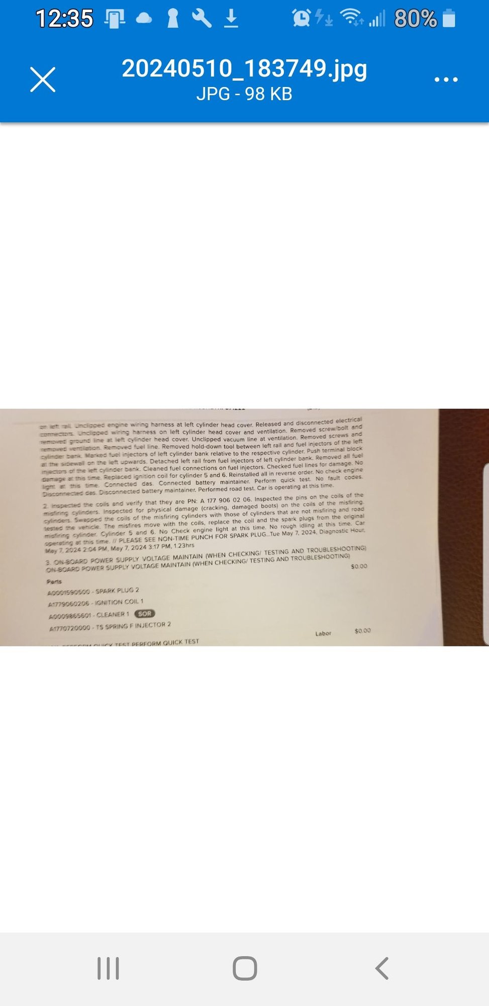

As I posted here on April 8. I had cylinder 5 & 6 misfired Both Ignition coils and spark plugs were replaced.
I noticed in para1 below that the MB tech. detached the left rail from fuel injectors of left cylinder bank. Removed all fuel injectors of the left cylinder bank. Cleaned fuel
connections on fuel injectors.
See photo below on what Parts were used to correct the misfires.
Don"t know if this information will help but wanted to post it in case it does.
I also noticed in para1 below that the MB tech. detached the left rail from fuel injectors of left cylinder bank. Removed all fuel injectors of the left cylinder bank. Cleaned fuel

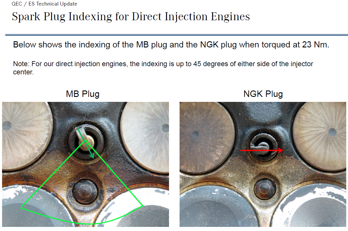

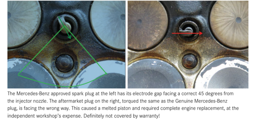

Also, OP's car was taken to an indy and had all plugs changed too. Could spark plug indexing play a role in causing a different cylinder to misfire? Or would that be a fault registers a misfire later on?

Good point about the spark plugs. As I understand it, these engines are also sensitive to having correct spark plug gaps. Also, they now messed with all cylinders. Simply removing the spark plug and replacing it could have dislodged some deposits. At some point it may be worth taking a peek inside all cylinders with a borescope and inspect their condition along with potential carbon deposits on the valves.
