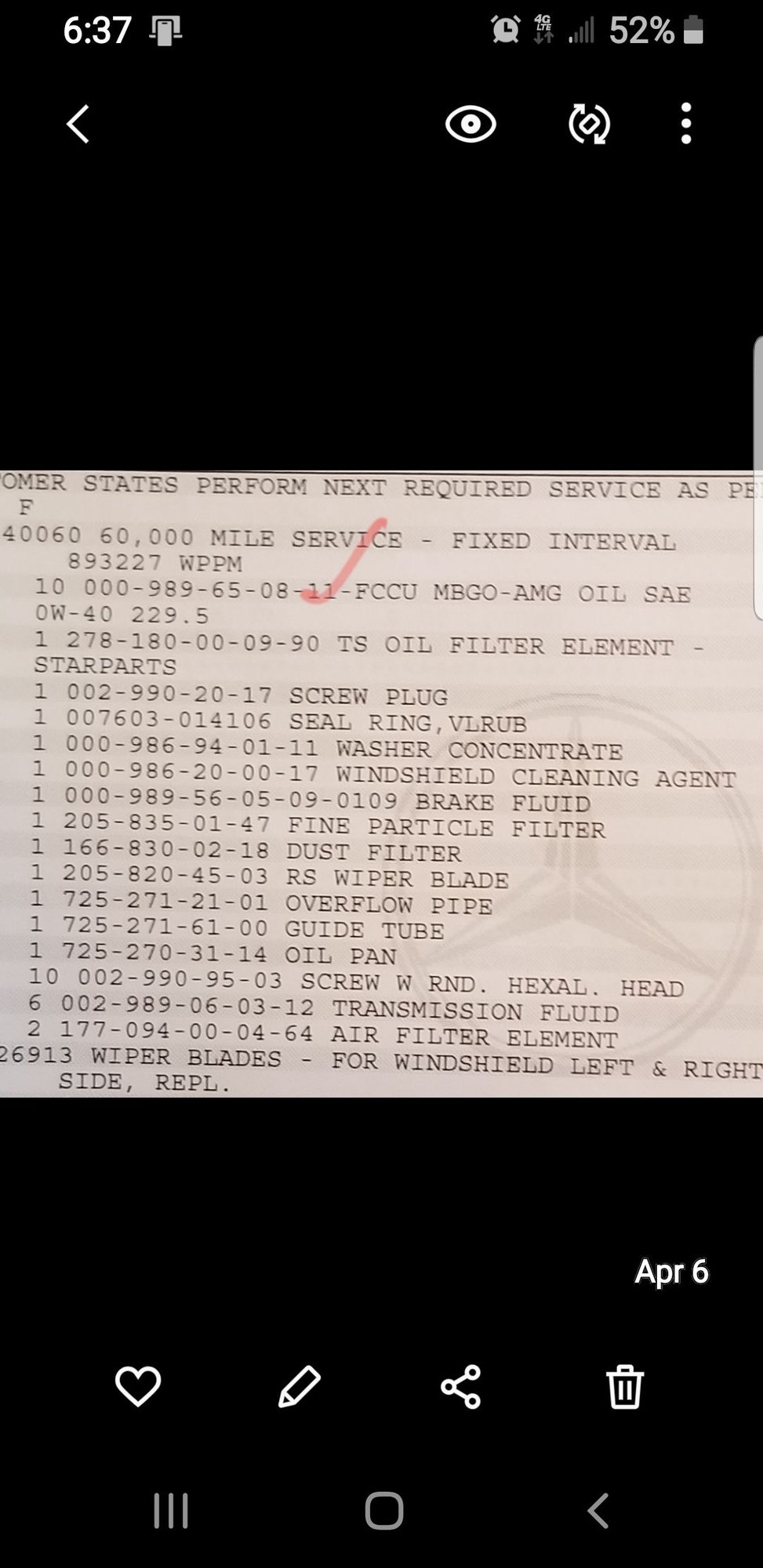

I also have a 2019 C63s coupe. This past April had the required 6 year Service performed. See photo.
The oil used at MB Dealership was. MB AMG OW-40 229.5
If you haven't already, the required MB 6 year/60,000 miles is due. That is the B Service with full Transmission Service. See photo below what other services were performed.

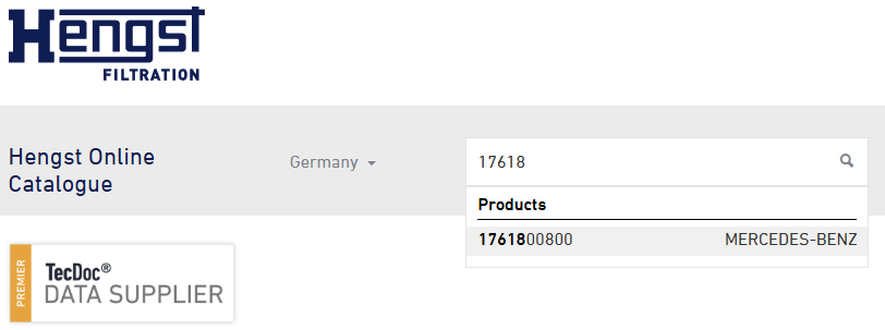

Amsoil 0W-40 European
Hengst 1761800800 Filter

Are we really able to use these in our engines though? This m177 came with a paper filter from factory. When I go to the parts dpt they tell me the paper filter is the proper one. Same thing with the Hengst site. I wonder if the fleece ones have different flow properties and if that even matters? Maybe I'm overthinking it.

@W140King Yes, you can use this filter.
I'm guessing the Mercedes paper-filter from the factory was a cost savings thing.... not to mention the stealer-ship is more than happy to price-gouge you for those paper filters. The Hengst synthetic filter from FCP Euro is only about $20
You can search the main website here: https://catalog.hengst.com/en/online...ch/?catalog=eu
When you type in the part number "1761800800" and click on the suggestion, it brings up their internal part number E155H01 D122 .... DIRECT LINK
If you use the Hengst website: https://showmetheparts.com/hengst/ the "1761800800" part number will not come up, and you have to search by year, make, and model, which then brings you back to the same filter Part Number: E155HO1 D122 (which has a fully synthetic filter medium). The list of compatible vehicles shows it is for numerous Mercedes AMG vehicles. including the C63 and C63S.
... if you really dig into the specs on the Hengst website this filter fits vehicles with Body Codes of either 205.087, 205.387, or 205.487
Lastly, In case anyone is curious here's the paper version of the same filter on the Hengst website: Same basic part number.... same measurements.

In April, my yearly MB Service they used MB AMG 0W- 40. 229.5. I been getting my oil change every 6 months. So 6 months prior to the April MB Service I checked my invoice and realized the Indy used Mobil 1 5W-40.
