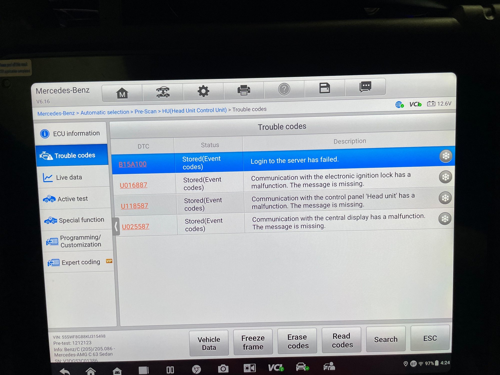

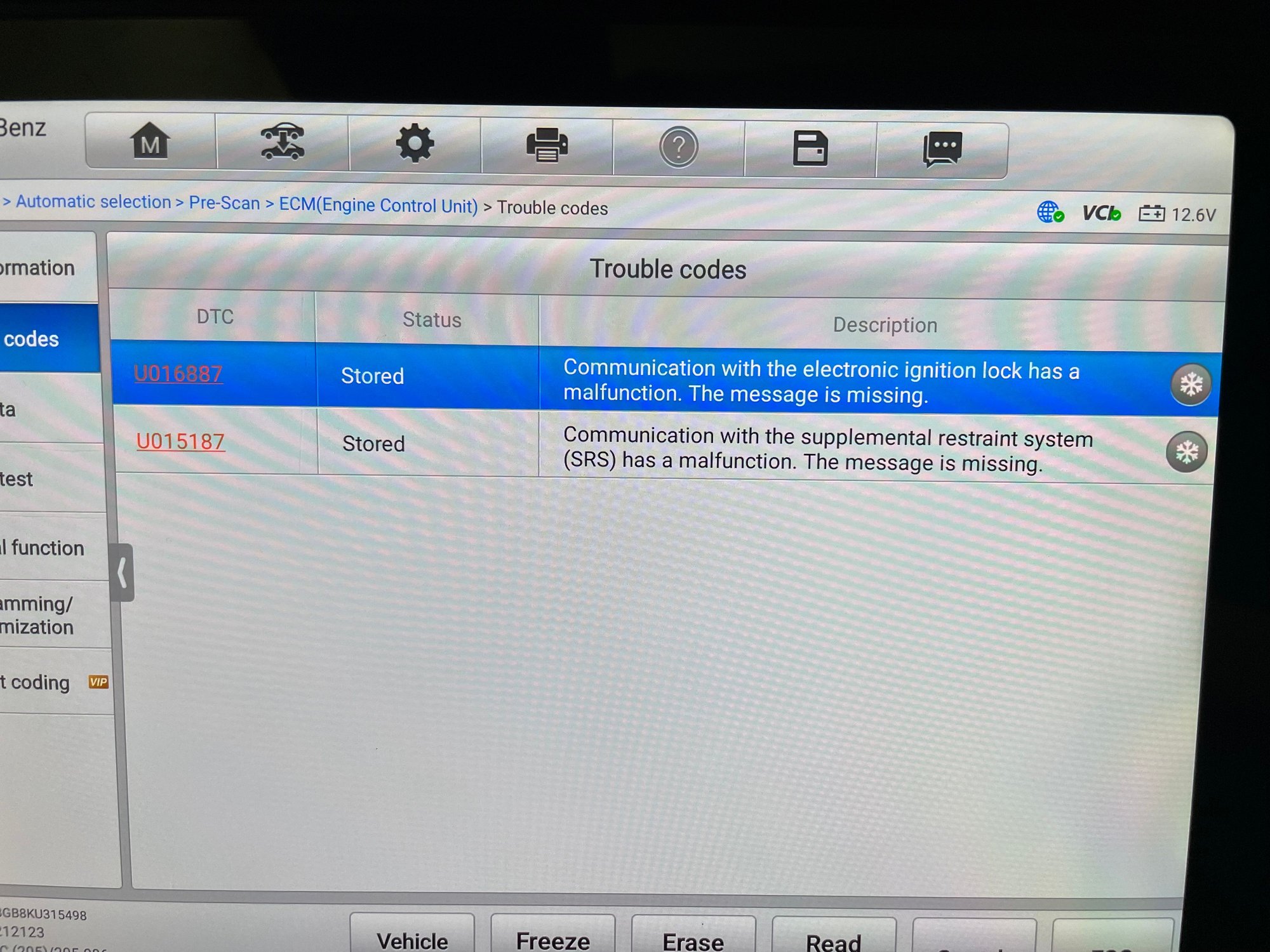

Here are a few codes. Pretty much all say almost the same.
Battery was checked by a technician and the scan says both battery and alternator are good.

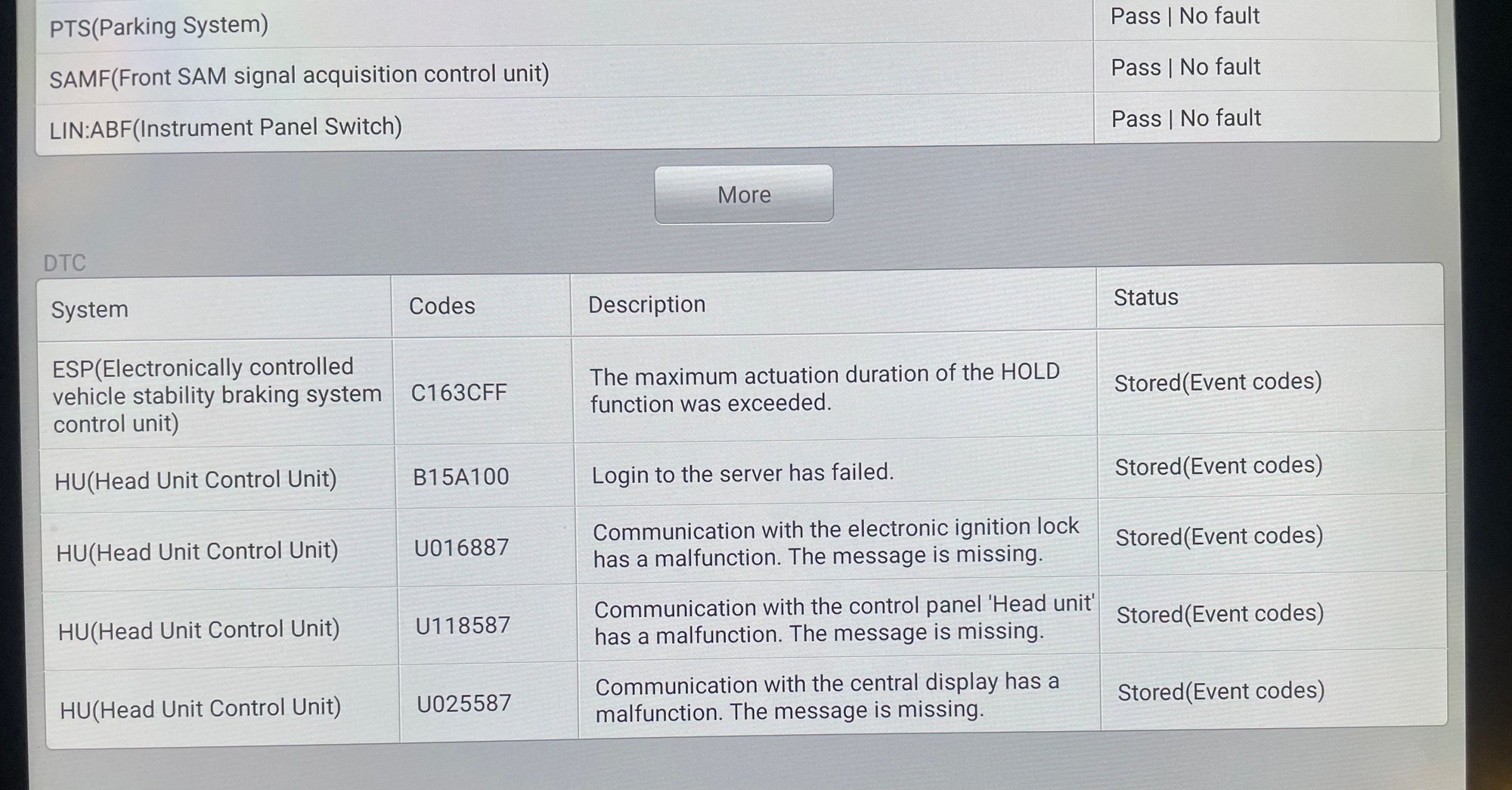

Ok, finally had time to trouble shoot. Turns out the new battery made all DTC go away except the esp and HUD. However, there is a humming noise coming out of a module located underneath the coolant reservoir. Not sure what that is? See video attached.
here are the last few DTC.
