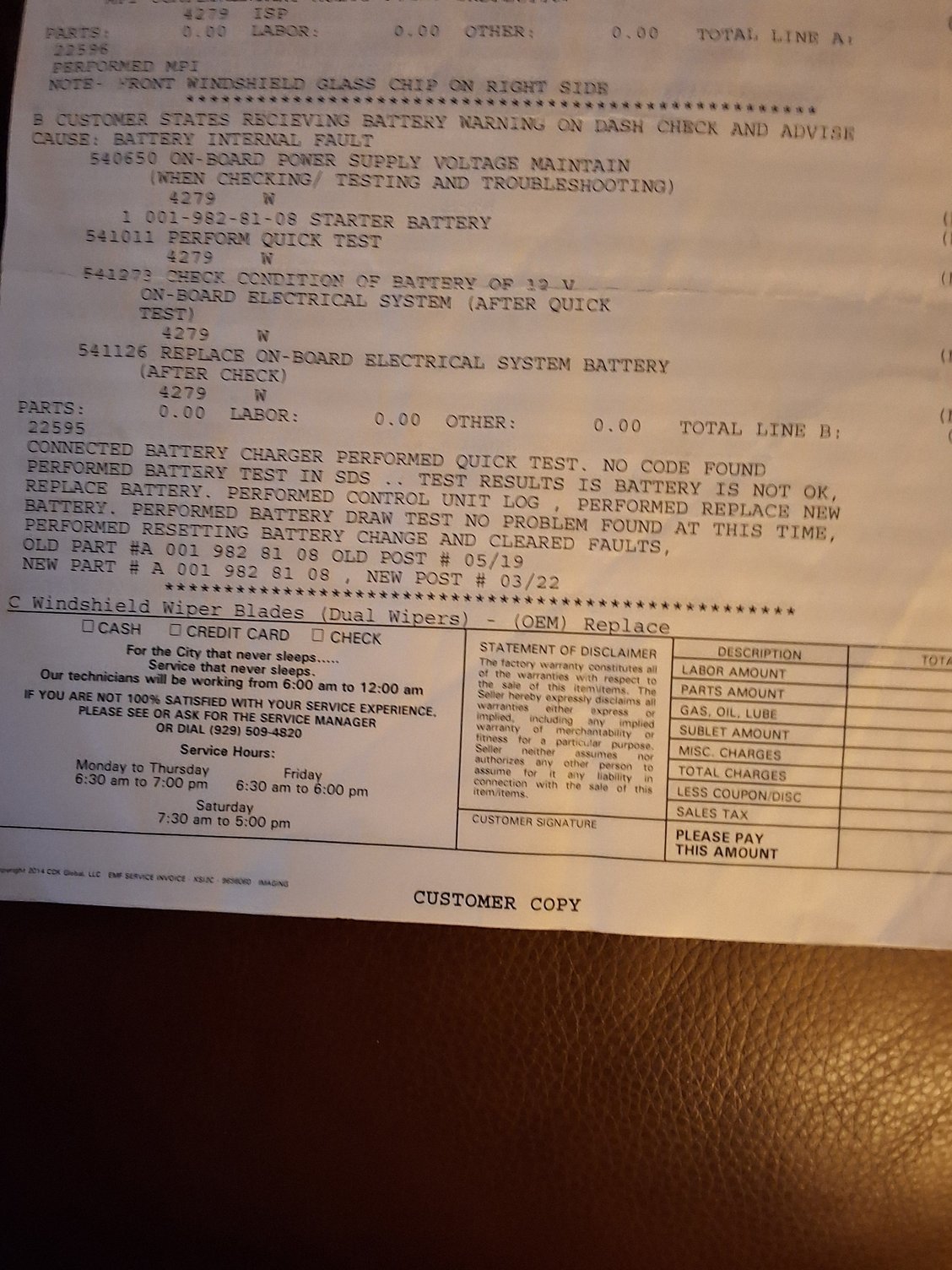

After 3 1/2 years my battery on me commect app would always show Partial Charge. 2019 C63s coupe.
Then an in dash warning appeared see photo below (lower picture) I called the dealership and said to bring it in instead of driving for extended period to re charge it.
So I drove over and the battery was not OK. They replaced it while I waited.. It was still under warranty. See invoice below on what was done.
