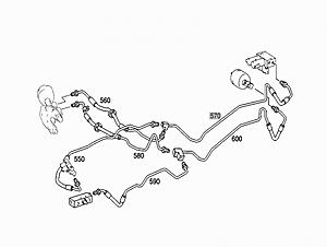

Are you referring to the large black bulb which is the nitrogen charged pressure accumulator (#410 in the pic below) which screws into the valve unit #400 ? Or a hose #560/#580 ?

Thanks awiner. I am actually referring to item #420 in your drawing.

The part your looking at is a "Sender Unit" Part # A0125429217. EPC indicates this part is NOT available separately from the valve unit any longer. The entire valve unit is priced around $1000!
See: http://www.pelicanparts.com/cgi-bin/...C%20CL55%20AMG
There is a "Repair Kit" Part # A2203201158 listed for this however. You may want to inquire what this repair kit is all about. Looks like it is a $80 part.
Have you tired to tighten the sender ? The torque specification for it is 50nm.
If you remove it, fluid will come out but as long as the car isn't running and has been off for a while the pressure wont be high.
