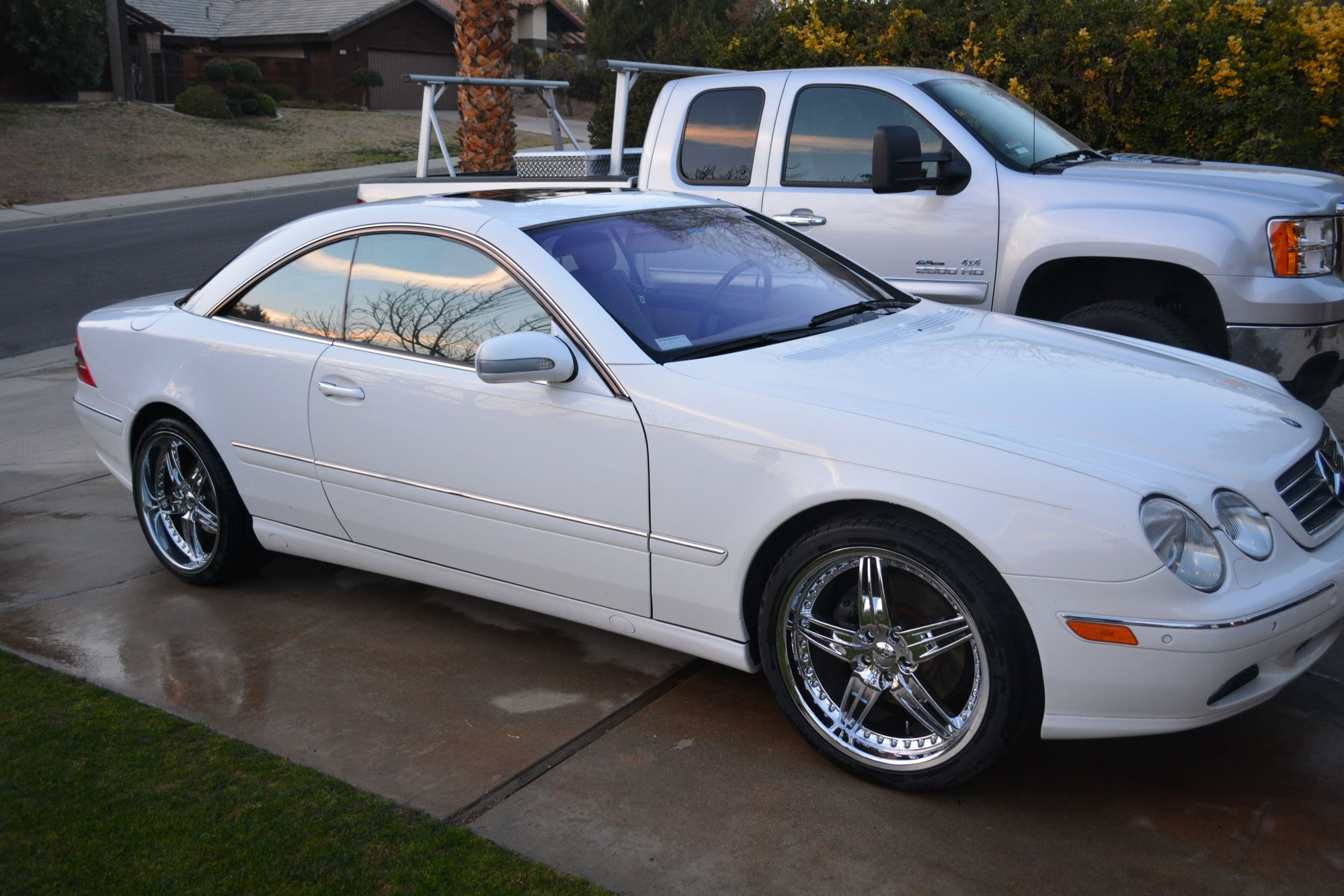

Leak free at the casino....<br/>
Old Oct 19, 2014 | 10:23 AM
vmystikilv's Avatar
Joined: Feb 2009
Posts: 780
Likes: 11
From: Dallas, TX
Range Rover
Anyone can post a pic off the internet....

my car not some internet pic
