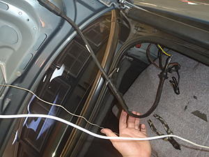

Had the same issues on two W215's. First check the fuses. You should be so lucky :-)
It is almost certainly a bad wire in the bundle that feeds the trunk, which pulls out and stretches when trunk is opened. Bundle is at right rear near the hinge. One way is to open the bundle (take off the retractor mechanism) and look for bad wires. Another way is to check each wire with a multimeter where it terminates at each place on the trunk accessories (have to take off the trunk trim to expose all the gadgets, which is not hard). If it's supposed to be hot (12v) it should be, grounds same. You can check by running temporary feeds and grounds from the taillight harness by using alligator clips. Find one that shows no current, use a temporary feed, and verify if that's the cause. At that point you can run a new wire or repair the broken one in the harness. This cause and fixes also work with "No 3rd Brake light" and other codes and issues in the trunk.
The other possible reason for your issue is a loss of vacuum to the trunk release. The trunk release is a combination of electrical and vacuum-actuated devices - typical German Over-Engineering :-). Search for posts on how to re-epoxy the release valves and for checking vacuum lines. If you had the problem come up all of a sudden, however, I would vote for cause #1 above.
