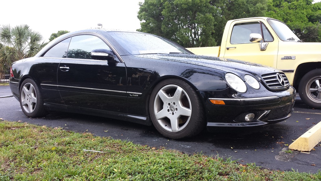

2003 CL 600
My two AMG package '03 CL600s had the flat wheels. As have all the other ones I've ever seen personally.
Old Jun 15, 2016 | 11:57 PM
tusabes's Avatar
Joined: Jan 2008
Posts: 6,150
Likes: 533
Mercedes
Interesting , all the ones I've seen have the lips , like eBay item 262411769917
Looks like they fitted both types of rims
