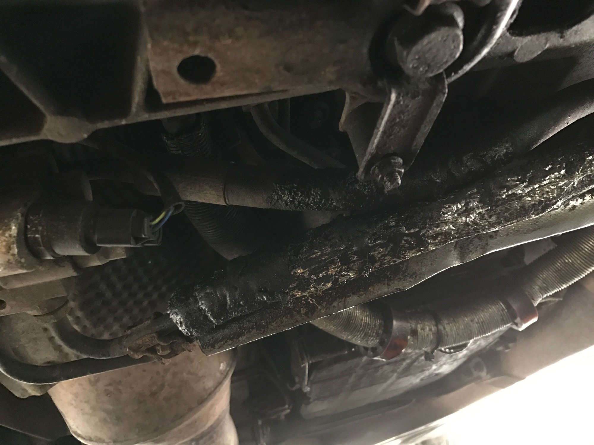

Originally Posted by stuartph
Their is wetness on one of the hoses that runs along the front of the car
That's a warning sign of upcoming failure. You need to repair or replace the hose, or it will let you down.
Too many of us have learned the hard way, and don't want any more to suffer.
Nick

With my CL, I had wetness on a couple hoses. Funny thing was, when I wiped off some of it with a napkin and it was orange. Turns out, some of it was transmission fluid, some of it was coolant. If it is green, get a new hose on there as soon as possible. Nick is dead on, a failed hose will leave you stranded and always sooner and more suddenly than you expect.

Thanks Guys
i shall get under the car tomorrow and confirm the hose or hoses plus stop using the car till it's fixed
I will update my findings

Well I went leak hunting this morning and found them....
Plus the sump pan has a weep , sump plug washer need replacement also plus the small rad in front right wheel arch has a little weep on the bottom hose.
