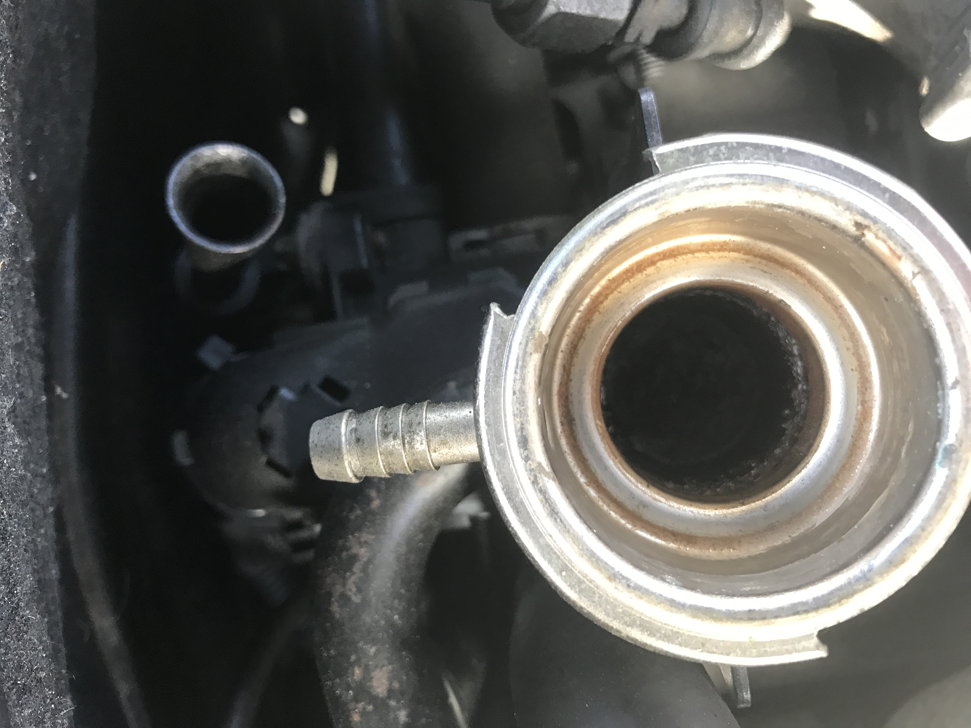

In the following picture of the charge cooler top up cap , should the water level be near the top , I topped up with anti freeze and I know I will need to vacuum bleed
Also is there a dipstick missing from the tube behind in picture

Yes, it needs to be vacuum bled, and yes, the coolant should be at the top.
I bet a lot of V12TT's are like that, and will be much slower than they should be as a consequence.
The Mercedes IC bleeding tool uses a compressed air vacuum pump, which is quite inadequate IMHO. This is what you really need:
Vacuum refill kit:
Rotary vane vacuum pump

There's no dipstick missing, though the dipstick tube cover / cap is missing.
That's the tube for the transmission dipstick, which is a garage tool
Readily available on-line. They stick out of the dipstick tube when inserted.
Definitely worth getting. Both difficult and important to get transmission oil level right.
Nick

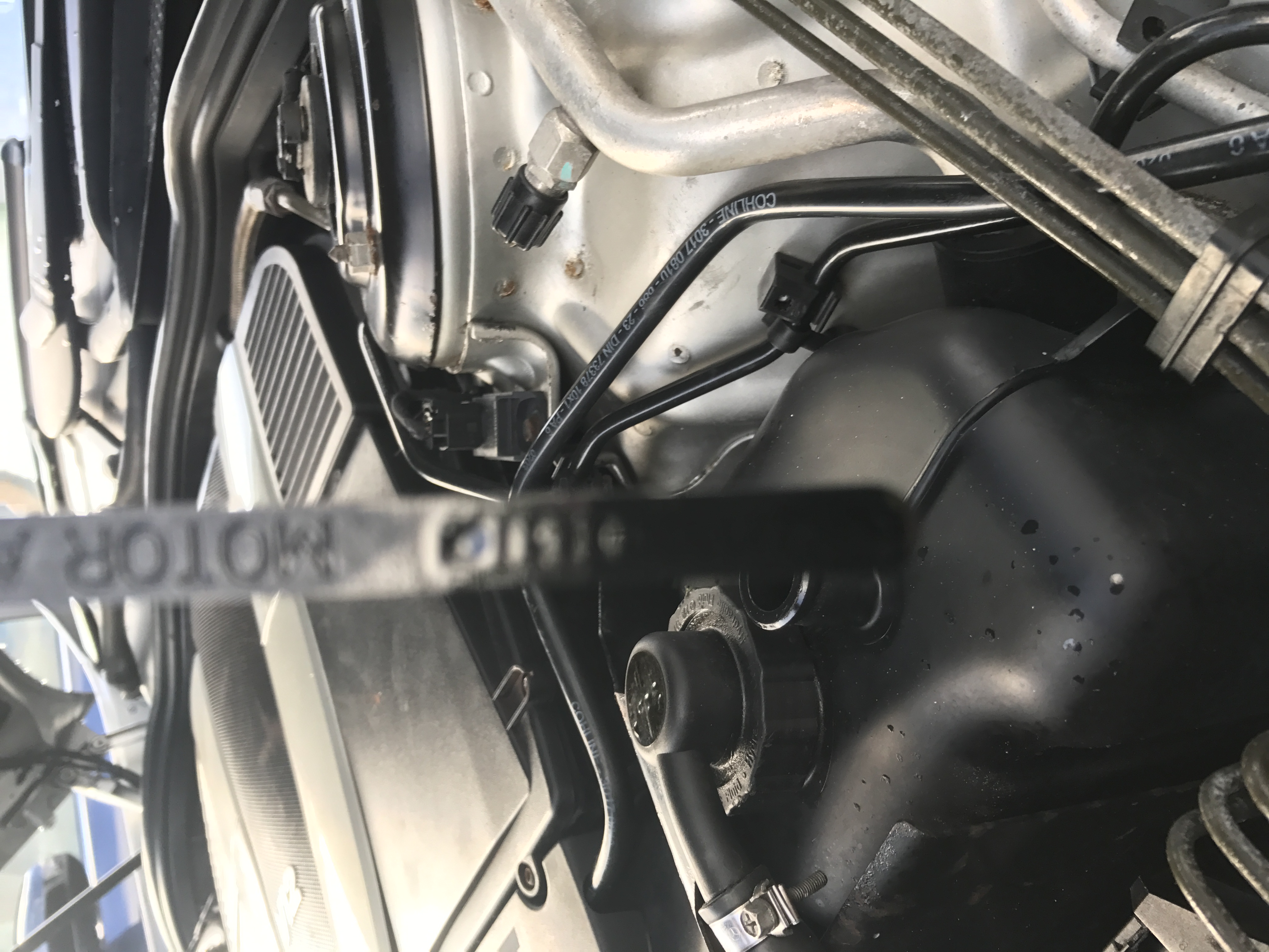

Here is a pic of ABC level with engine running, it's at lower part of dipstick
On start up engine cold and not been run over weekend , loud buzzing can be heard and felt from oil filter housing , went away when hot, oil level on dash display says oil level correct , is the noise normal?
Stuart

Any sign of leaks from any of the ABC hoses or struts? Any corner of the car drooping overnight?
Old Oct 21, 2016 | 06:43 PM
tusabes's Avatar
Joined: Jan 2008
Posts: 6,150
Likes: 533
Mercedes
Originally Posted by stuartph
Guys
Stuart
a loud buzzing on startup is a symptom of a failing pump
Old Oct 22, 2016 | 09:03 AM
stuartph's Avatar
Joined: Aug 2016
Posts: 75
Likes: 8
Cl600 TT
Their is wetness on one of the hoses that runs along the front of the car
the buzzing is from the oil filter , could it be transferred from the pump? To the oil filter housing
