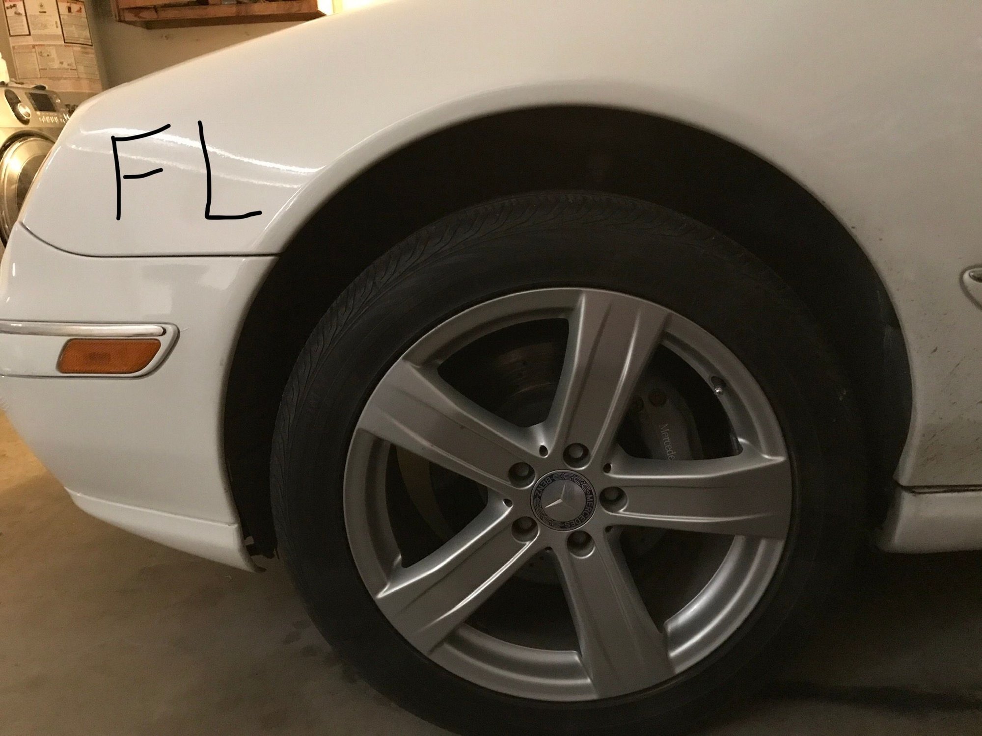

I just got this car(2002 cl500) and I noticed the suspension was a little off, the front two are even then the rear are a but lower(not sure if it’s supposed to be like that) and the rear passenger side is about an inch lower than the rear drivers side. After turning the car on and raising it up, it only went up a little but it’s been over 10 hours since and it hasn’t lowered at all so I think it’s safe to say there’s no leak. So at this point I feel like it might just be some sensor that might be at fault.
Previous owner information:He said he had just got a new key, he had changed out a dead battery with a new one.

Hmm I think we are getting ahead of ourselves with this problem.. lowering links because the abc won’t self-level?
I’m not sure about your level of mechanic ability but you should be able to do two things at the least-
1. Jack up your car
2. Remove tire/change spare
i think first we need to visually inspect your height sensors, with almost 300k miles they are very likely damaged or coming loose. the fronts are fairly easy to inspect, they are connected to what’s called your upper control arm. It’s shaped sorta like wishbone
rear ride height sensors are harder to find but easier to diagnose in my opinion. Remove the rear wheels, and INSIDE front your Lower control arm in the rear you will see a small arm that connects to a sensor on one side and Connects to your rear control arm on the other side
these sensors in the rear are particularly prone to damage in my experience, especially if someone inexperienced had worked on the rear suspension and didn’t support the control arm while dropping the rear wheel hub/arms
