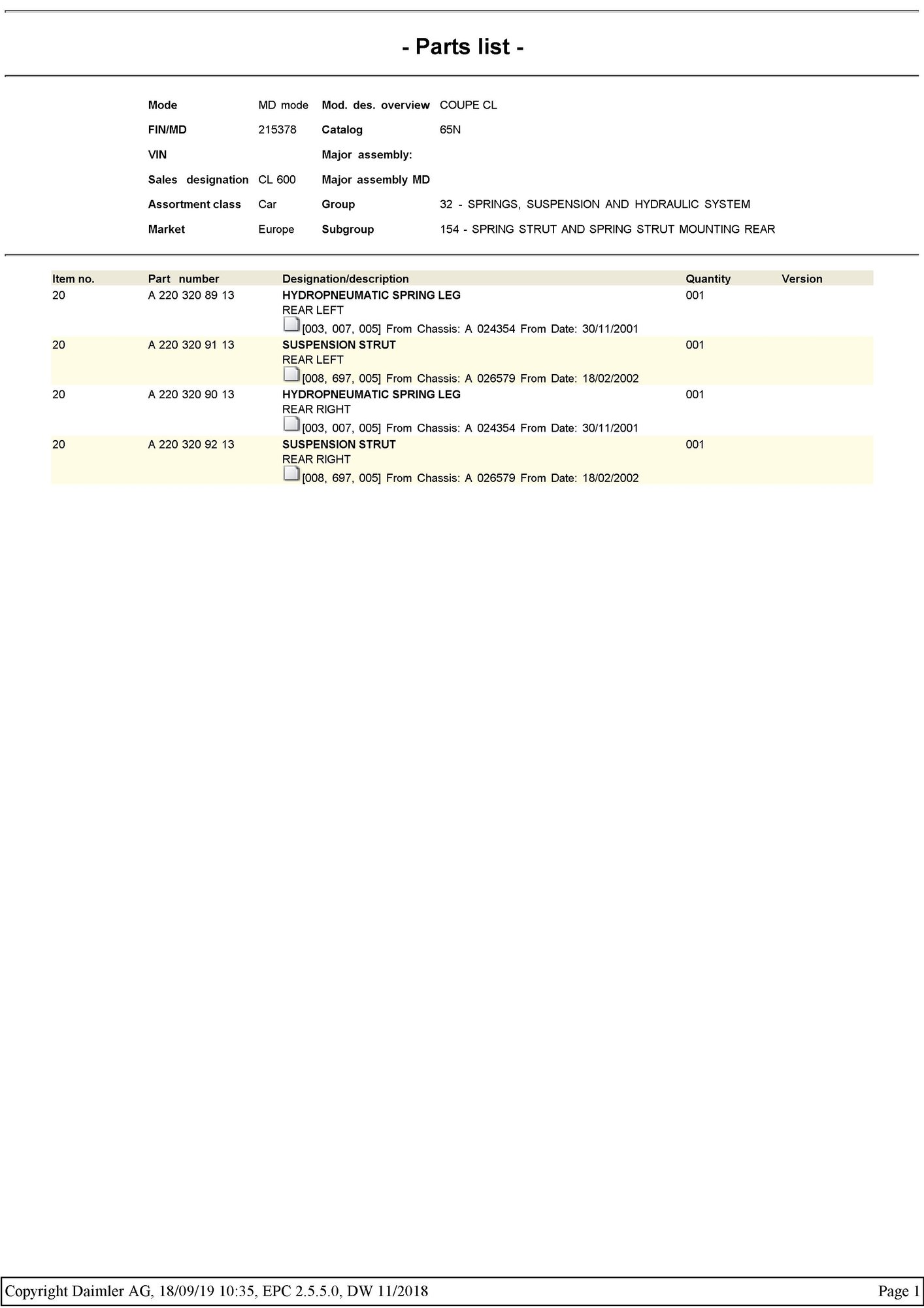

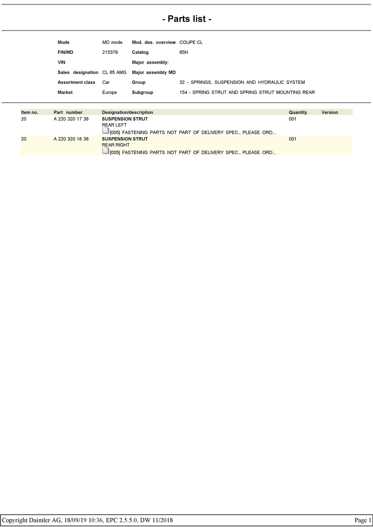

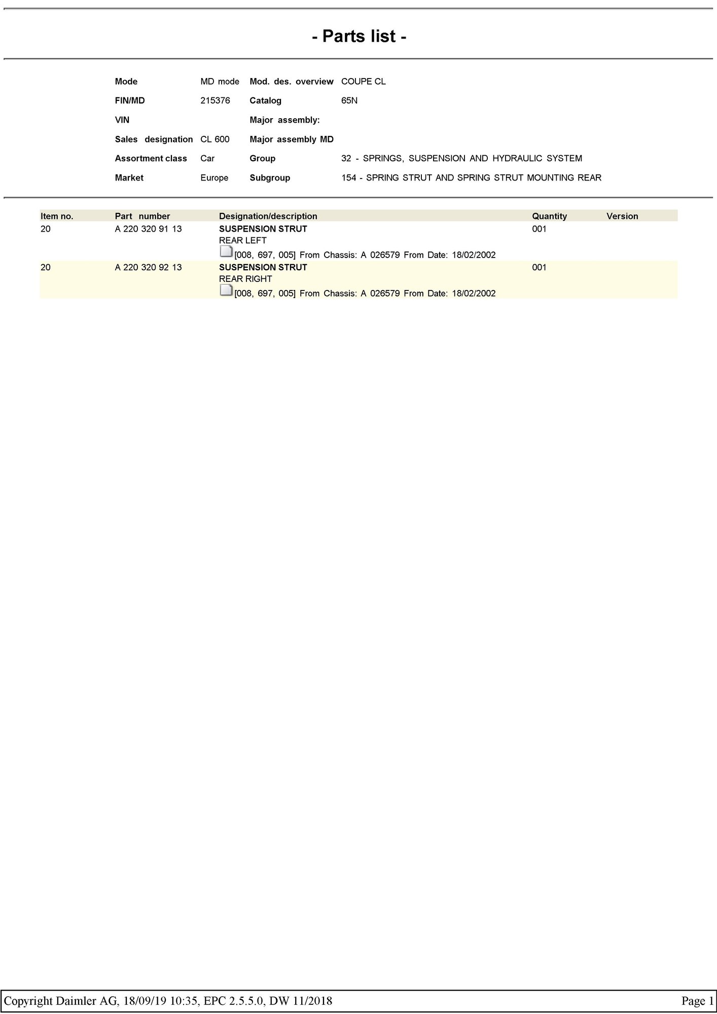

AMG package looks like not to be AMG CL65 suspension at all
best way to find out is read the part number from your "amg" package CL600
MB scams a lot with AMG packages (often just a setting instead of different hardware)

even if they have different Numbers ? and what about the spring rates ? where does that info come from ?
and oops you did not mention CL65, CL65 ?

To me, I would agree that the hydrolic part is the same but mayby not for the 65 AMG
but all these part numbers might hide small or big changes, and springs rates
