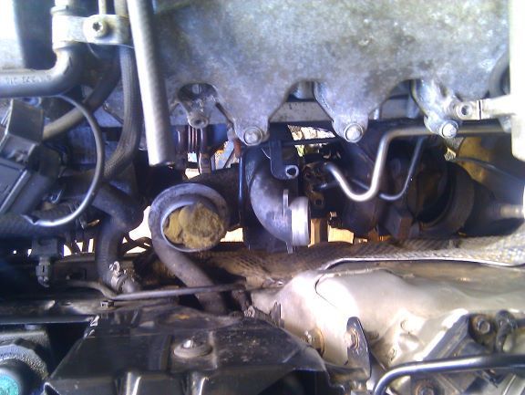

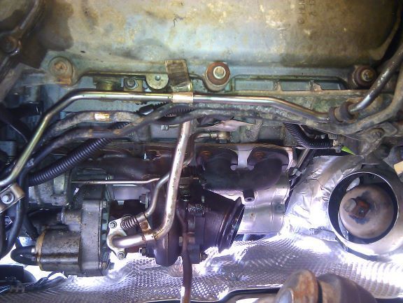

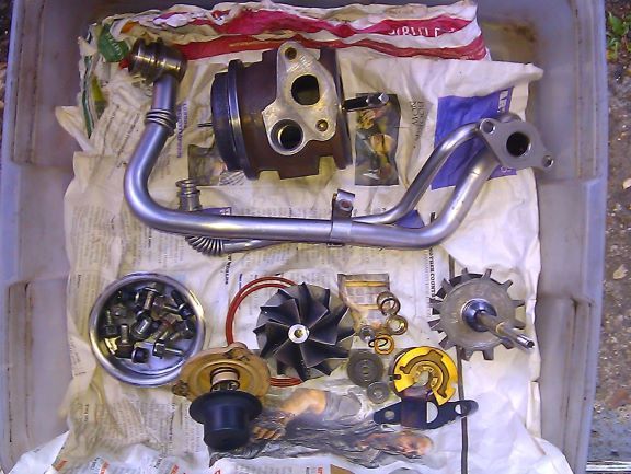

I removed the front subframe and left the engine in place, which reduces a lot of the work, but it's still difficult.
My turbos had burnt oil, so I simply rebuilt them with new bearings etc. My car was re-mapped, but I've heard a lot of people have problems when they try to upgrade.
The simplest first step is a re-map, and the second step to fit S65 turbos, which are slightly larger.
When I fixed everything and got the charge cooling etc working right, I broke the transmission, so then I had to repair that.
