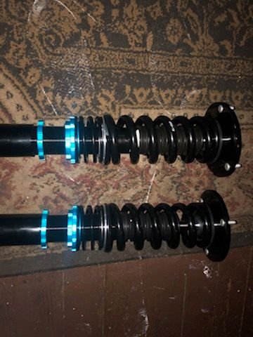

Ceika
These are the Ceikas I ordered. They ride fine however haven't had much road use since they have been installed. They seem solid and hold the car up well. Not much bounciness as I heard with the yellowspeeds. I got the 16kg front 12kg rears with all four helper springs. Will be adding aircups in the next upcoming week's.

Originally Posted by Puerto Rick
Keep us posted. I don't know about the swap but I am interested in the coilover swap. How do the Ceikas ride? Did you get comfort springs? did you opt for the adjustable rebound & compression? What spring rate did you get? I am thinking of switching from Yellowspeed to Ceika. Good luck with the swap!
Thank You
Rick
i installed some cieka coilovers for someone in my area and got to test them as well
they are identical as the yellowspeeds...
however cieka as a company is MUCH better about offering different spring rates, and some other options like their “air cup” to raise and lower the car on air cushions, and “helper springs”. On the other hand if I recall correctly, yellowspeed was faster about shipping
My overall opinion of yellowspeed 20/14kg spring rate setup VS cieka 14/10kg setup Is that being the same struts/components, it rides very similar to the yellowspeeds of course, fairly tight and accurate driving around the city/neighborhoods.
at first I believed the cieka 14/10kg spring rate had solved the bounce issue I experienced with the yellowspeeds... but instead of bounce around 35-100mph, the bounce was still there yet instead seemed to happen at different speeds than the yellowspeeds
