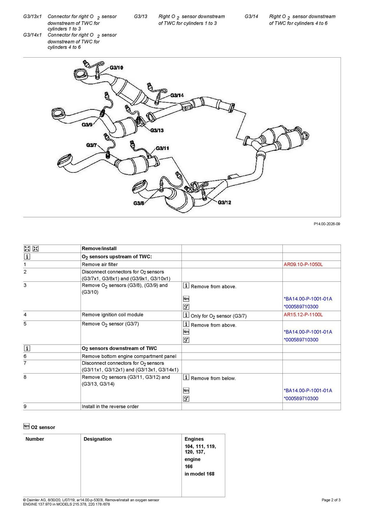

Please advice and show any information about UP, DOWN stream of O2 sensor replcaement on cl600 (2001)
Wish to change the set(4) but does not know which is Down nor Up stream and its Location.

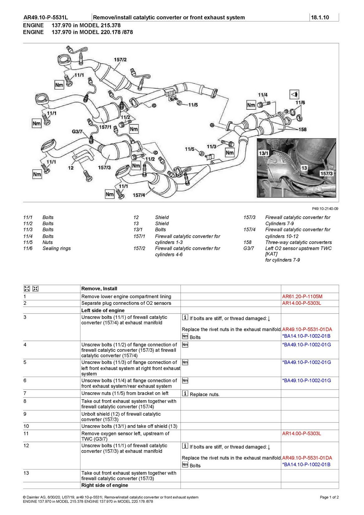

  • Bank 1 Sensor 1 is the upstream (pre-cat) on the passenger side.
  • Bank 1 Sensor 2 is the downstream (post cat) on the passenger side.
  • Bank 2 Sensor 1 is on the upstream (pre-cat) on the driver side.
  • Bank 2 Sensor 2 is the downstream (post cat) on the driver side.
always replace by pairs, like tires ! left and right
so both upstreams or both downstreams, or all 4
