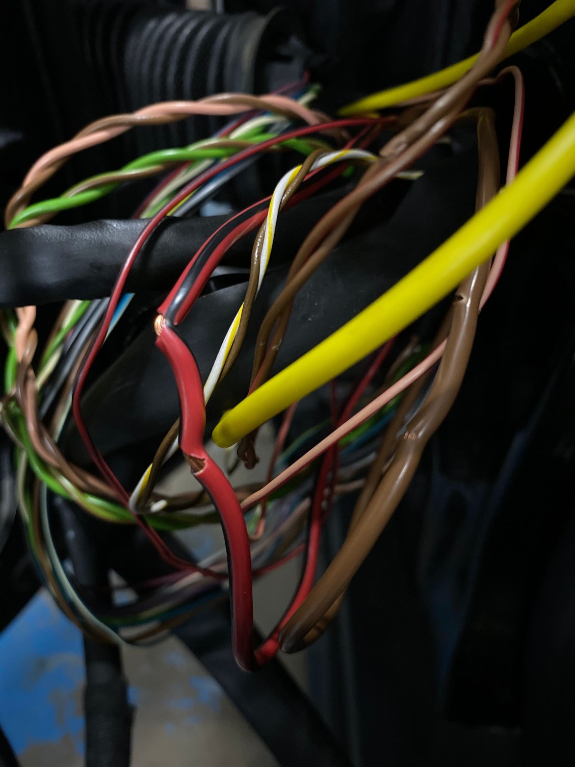

And it starts.... My reliable CL600 has finally given me my first aneurism.
No passenger front window, no seat controls, door mirror or lock. Failed with the door open, so though the rear window works, it won't raise all the way because it still thinks the door is open. (Still had to dick around with the door card to drop the front window in order to close the damned door!)
On-seat controls seem to work (Pulse, lumbar etc), though the auto seat-forward movement had long failed beforehand - will ask about this later
First place is the usual door wiring in the accordion connector - found a few suspect wires in there including the main live and ground. They are not severed but the brown (N?) and red/blk (L?) sheathing (among some other colours) has opened right up. Hoping to find enough strands have failed to drop the current.

It seems that the wiring is not severed. I have clear continuity between the exposed wiring and the connector.
Can anybody tell me where the other end of the main door harness goes?

Cheers Adlianooo. It definately sounds like broken wiring for you. If it all works with the door in one position and not in another, the first place I would be looking is in the accordion boot for the door shut. (the clips are top and bottom if that helps - I just gave it a bit of a shove downwards and it came free).
As for my car specifically, I got to the bottom of it. Hope this helps someone else.
Turns out I cannot count
The neutral return DOES go back to the fuse box under the rear seat. It terminates on one side of the 25A fusible link.
The live returns to FUSE 13 in the F1 fuse box under the bonnet (Nearside RHD, Driver side LHD). It terminates on one side of a 40A fusible link. (Mine had a 15A in there)
NOTE: The SRS Airbag CAN be disconnected provided the ignition is off. I triggered no codes disconnecting and reconnecting in this way - no need to remove the battery.
This whole thread has been born out of my inability to count the spaces where other fuses would have been on other models. I did not count the first three empty spaces in the long row of fuses in the box (fuse 6/7/8), which is how I 'didn't' get to fuse 13.
Needless to say that the door now works again as it should - with the addition of the keyless go button operating (the harness clip had broken and was disconnected).

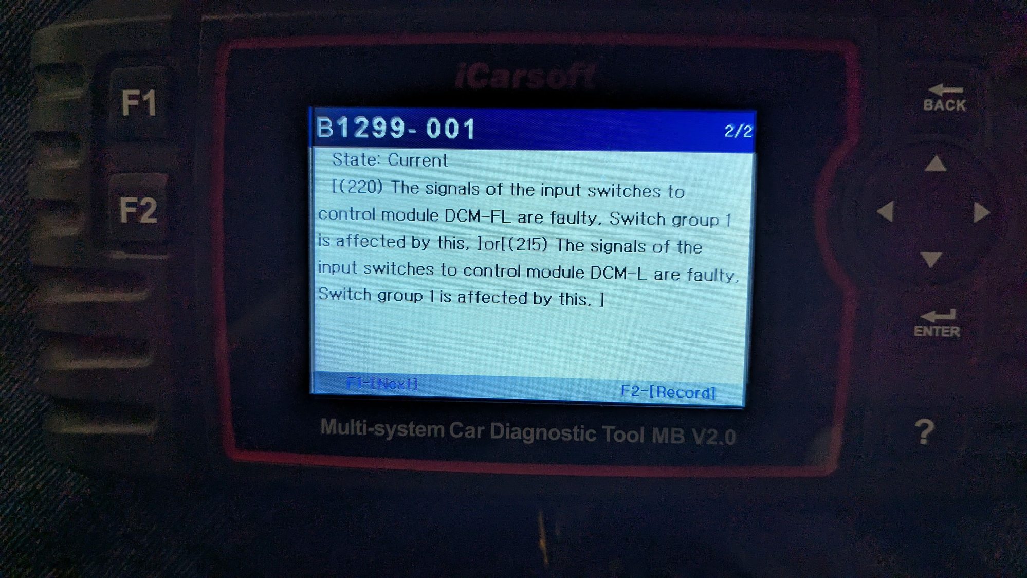

My 2003 cl500 is having a similar problem, but it's intermittent; passenger side door clearly has power as all lights are on but upon initial start up and during driving the window won't drop, the heated seat doesn't work and you cannot move the seat or open the door, when trying to drop the window using the driver controls you can hear the actuator activate but the window doesn't drop.
Then, when parked and engine is switched off (but ignition is still on) everything works as it should.
Someone seems to have been in the wiring harness before and it's a mess, but it was working properly when i first bought the car and for 2 weeks. My only thought is that since temperatures have dropped the cold weather has increased the resistance of the wire?
I plugged in a icarsoft diagnostic tool to see if it would give me anything, i've attached a picture of the message.
So, i guess my question is, do i just have a fault wire or door control module?
Cheers.
