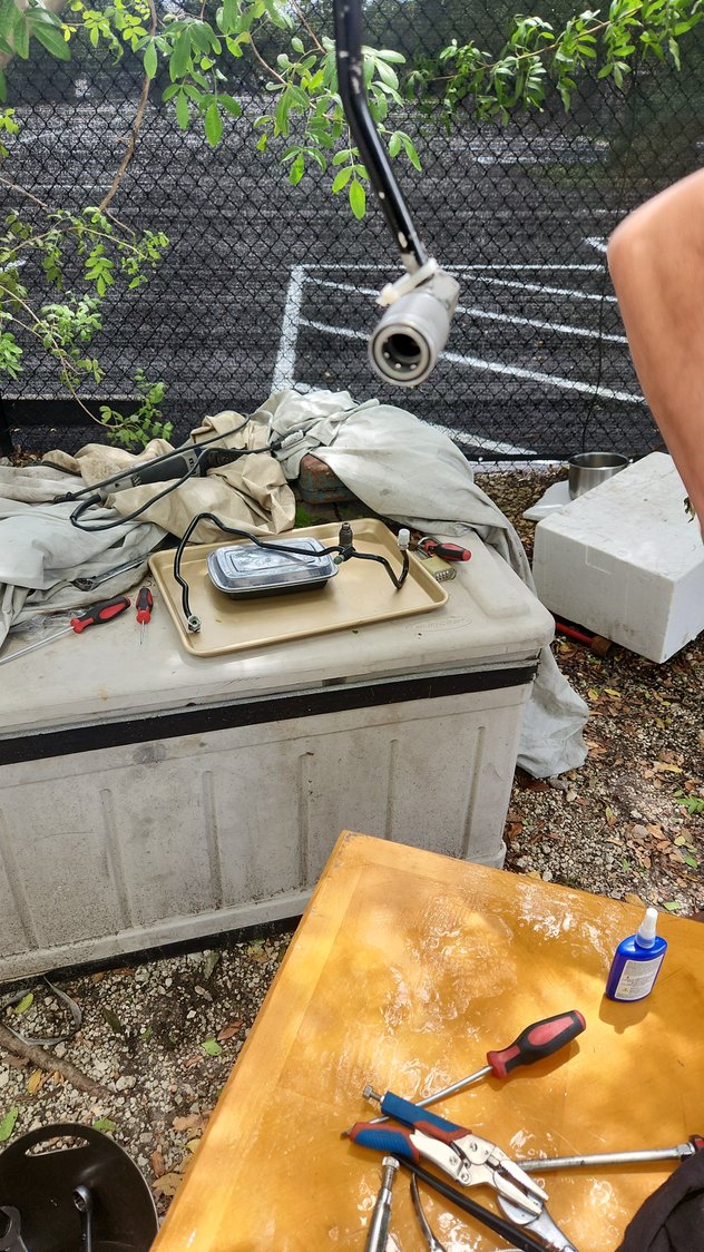

Aug 5, 2024 | 10:13 AM
As you can see I the picture I removed the damaged valve off of my line . . Only thing was my valve was seized qnd I need to get it real hot ti come out

Aug 7, 2024 | 07:23 AM
This was a trick I learned whilst at the hydraulic shop.
The quick disconnect is screwed into the block ending of the hose. You can unscrew only the quick disconnect from the new line's end block and install it onto your old hose, given the fact that the remainants of the old quick disconnect are gone.
Make sure to use thread sealer whilst screwing the new quick disconnect into the old hose

Aug 7, 2024 | 11:04 AM
Yeah parts man guy called and said figu4e it out ...so I did

Aug 8, 2024 | 07:05 AM
You seem to have damaged the threads, so I really hope it won't leak

Aug 12, 2024 | 03:57 AM
Its holding perfect . The thread was ok .looks worst then it really is . And the thread doesn't really stop the fluid . The O- ring is there to Handel that
