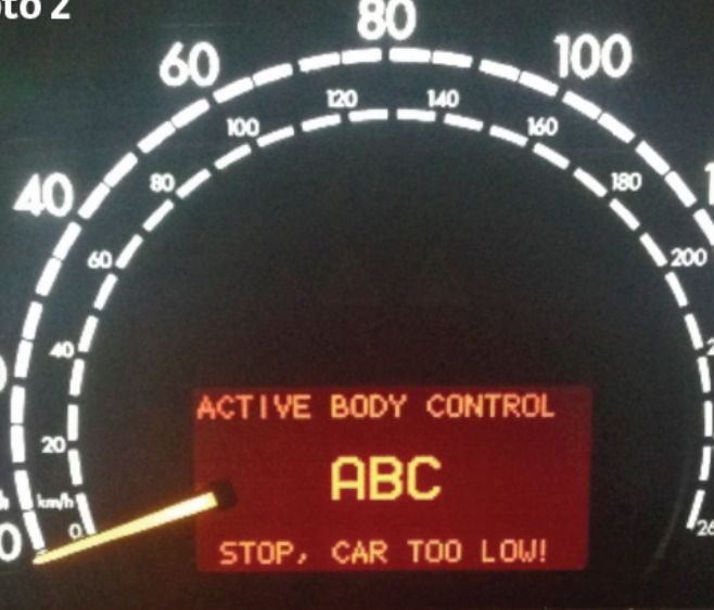

Did it look like this?

It was the red drive safely one
