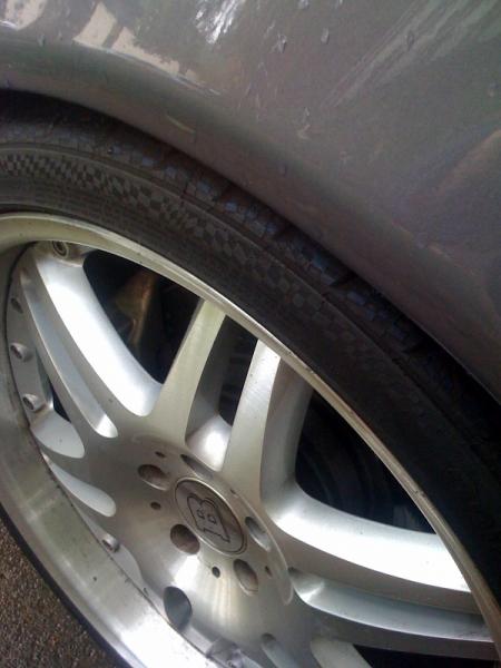

Originally Posted by ROMEO550
Maybe you can go to 295s
Hahaha - Never!
They may be tight but they still fit.

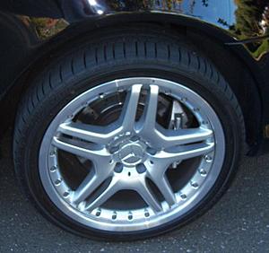

I have a CL55 and just bought stock SL65 wheels (the ones that are either titanium or silver with bolts and twin spokes). They were from a SL55 and fit that car fine. I thought they would fit my car but it looks like the offsets are off. Does anyone know if I can have the wheels milled to correct the offset? It seems there is plenty of meat where it attaches to the hub and there is plenty of clearance for the calipers. Any suggestions would be helpful, even if it means selling them and starting fresh. Thanks.
