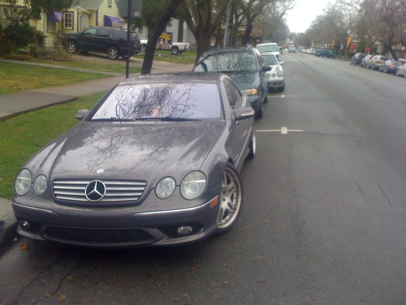

I have had 305/25s on my 2004 CL55 for about 3 and a half years now. See pics in the signature, or the one I just attached to try to show them NOT sticking out. On the CL55 (or at least on mine) they don't stick out if you have the right wheels. I don't know the offset on mine, but because Brabus made them for the car, they just work. Cost a little extra but worth it.
Because the car is lowered, I needed them to fit entirely inside the fender. I don't remember the exact post but I recall the 215 CL65 actually having less room for wider tires than the CL55, so I'm pretty sure just as Trakcar stated they would indeed stick out on the CL65. The CL65 is more car and simply has less room back there to squeeze in wide tires.
Years ago when I first posted about the 305s, the rubbing would occur on the freeway on large undulations, maybe every 10-20 miles for just a fraction of a second. Since that time (and over about 50,000 miles) it has happened less and less. Now it never rubs on the freeway and in fact hardly ever happens at all, unless I bomb into a parking lot or over a speedbump. In those instances (or for going up and down the streets of San Francisco), I simply raise the car with the button on the dash. I couldn't be happier with the setup.

I was waiting for you to chime in, you have been the pioneer with the 305's for the longest time. I think the key word you mentioned is the offsets. If they cannot be maintained by the rim or with spacers then the concern for rubbing is greater. As far as the cl65 compared to other 215s, I understand it has longer axles which requires a different offset(a flatter faced wheel with very little lip to prevent it from sticking past the body). I was interested in using 305 drag radials when they come out, with spacers if needed to prevent inside rubbing. the big question is if they don't tuck in the wheel well based on the rim and the raised abc fails, the plastic quarters will get chewed up if the car squats. So I don't think its worth the risk with all things considered for me and a cl65. However your cars stance is absolutely perfect, I hope you don't get tired of it, it will be tough to top!
