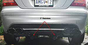

Here is a pic of my handywork... $5 and 1 hour of my time...

Can you take a pic of where you cut the hole? So you didn't weld, to add the down angled 3" pipe yet?

I cut the circles slightly downward so I could easily weld the 3" cutouts all the way around.
I made these cutouts by plasma cutting semi circles out of each side to it shared the exhaust pipe contour. Using wood to trace is easier than freehand plasma cutting.
You do not need to add the cutouts it sounds the same as the cutouts are very short. I just wanted to direct the exhaust gas and be able to close it with a cap or add the electronic cutouts easily.
To reverse this mod you only have to cut out a 4" piece of exhaust and slide a new piece in place. I bought a used 06 cl65 factory exhaust to use if needed but as long as I drive this car the cutout will flow... so nice...

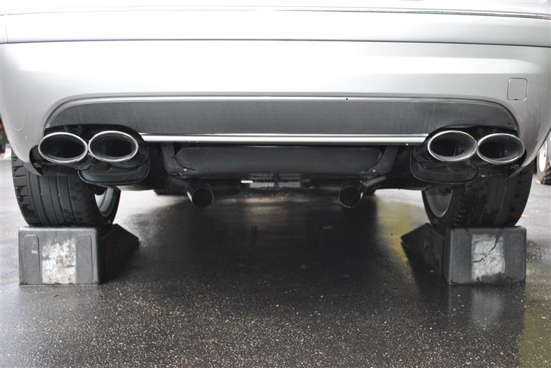

NRL,
Under your car you can see the bends that curve out towards the tires after diff. I choose the middle of the bend and went slightly lower than horizontal that way when welding the turn downs they clear the spare tire location.
Note: I am not an excellent free-hand plasma cutter. in order to do a good job, I cut out a 2" wooden disc and drilled a pilot hole in the center of the disc and in the center of the exhaust. then I attached the disc with a self tapping screw. After that the plasma cut was easy...You can also use the wooden disc to help cut out the turn downs edges
I was thinking of making a kit for people to purchase, but with so little of these cars it would not make sense... just stop by my house and i will do it for you for free.

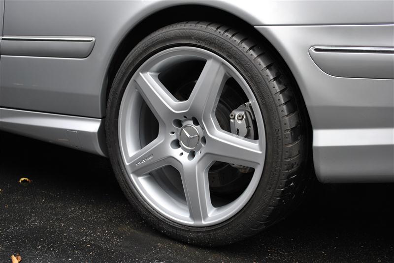

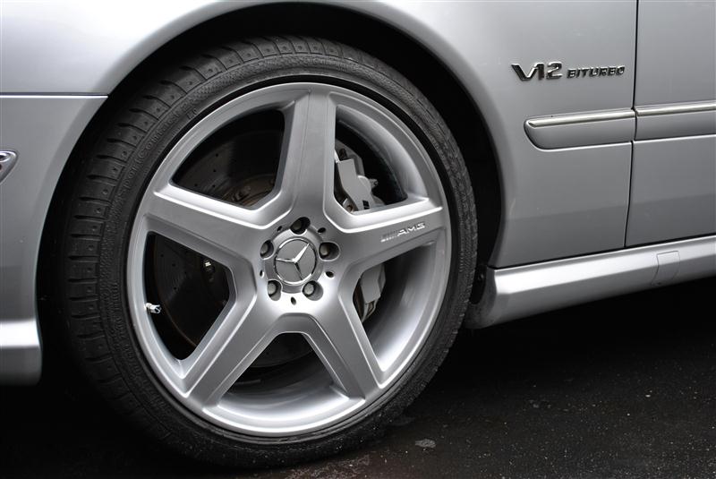

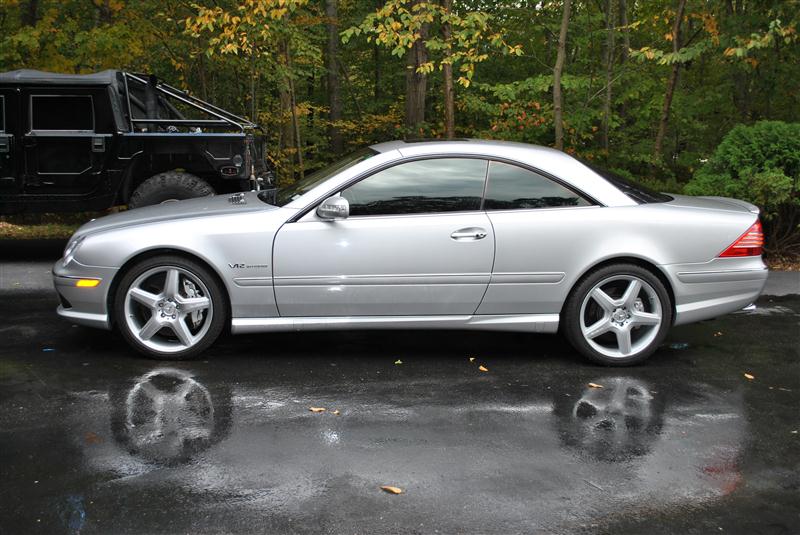

Here are a few more pics. I did finally get the newer CL65 wheels on it. I got them from Ernies in FL. I know some people have mixed reviews on them, but I can tell you that they came through for me. They sent the wrong wheels at first and then the wrong offset, but in the end I got what I originally requested for the price agreed upon. Time to refinish the original ones this winter.
