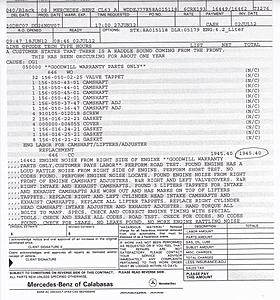

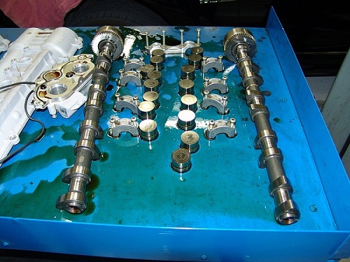

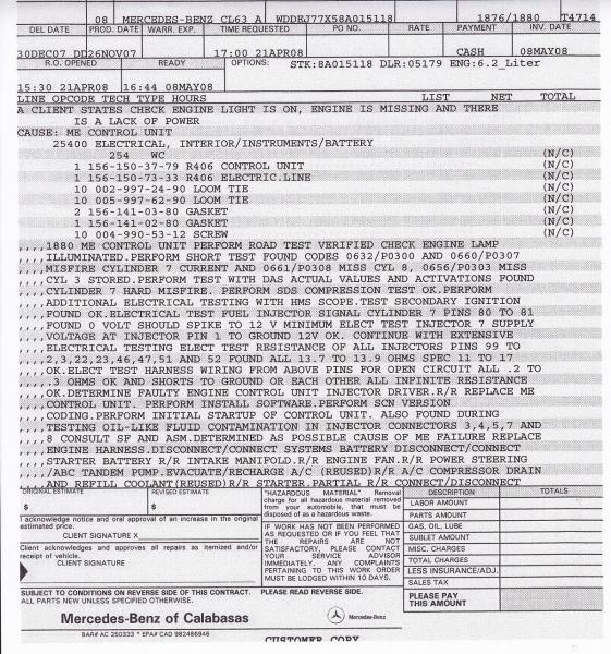

CL63 is the worst car I've owned in my 50 years of buying cars, at 1800 miles major breakdown, in the dealership for 31 days, at 16000 miles worn out cams and lifters, 4 months out of warranty WTF anybody else had this problem?

Originally Posted by C280 Sport
Oh good your car broke down... Now tell us details. Otherwise this is a useless post without facts,pics or any real information. I doubt you even have a CL63 or have ever driven one.
Need I say more!

I am on spead freaks side, post amount:time on forum means nothing! "FORUM" its in the name to discuss things in the open, not attack each other in the open. I havent owned a bmw for over 2 years now, yet i still spend time on 5series forums, just to see whats happening and chat. and it seem SPeedFreak uploaded some proof, that ought to shut some people up))
