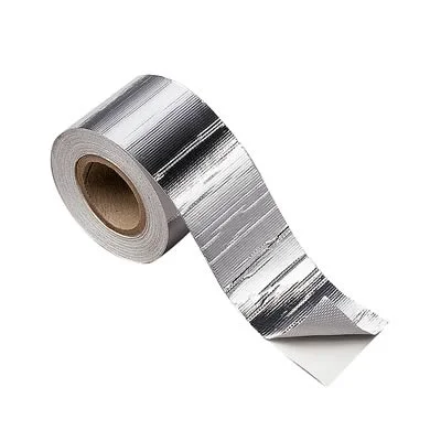

This is what I ordered, should insulate/deflect heat rather well..
And to wrap everything I ordered a couple rolls of this special tape
