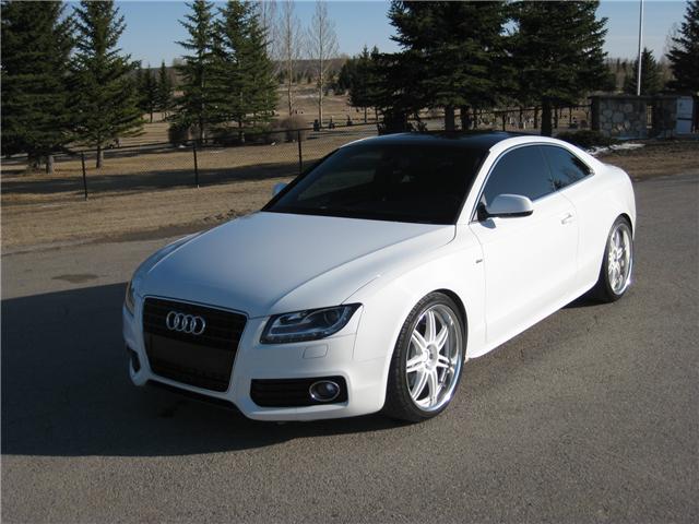

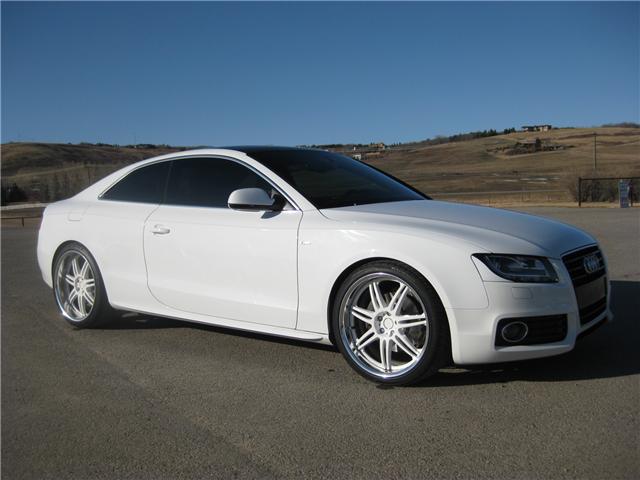

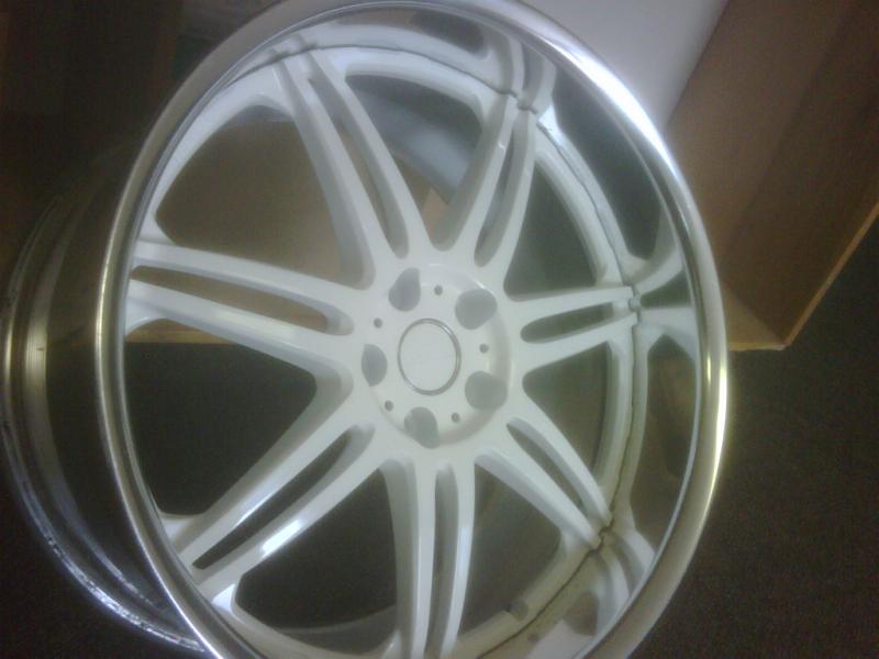

I have a set of 20" Work Varianza wheels. They were on a B8 Audi A5 and I am wondering if they will fit my 2003 CL 55. I know the bolt pattern and hub bore are the same for this generation of Audi and my CL 55. What worries me is the front wheels offset and the rear wheels width. Has anyone had an aggressive wheel setup like this on their w215 CL?
If these rims fit I am thinking of plasti dipping the center a dark grey or aluminum color and re-polishing the chrome lip.
Somebody with first hand experience and knowledge please help?

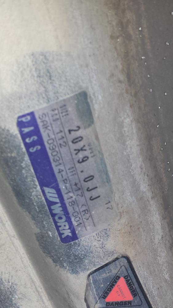

I am not sure about the disc, although it does say "R" within the brackets next to the offset on the label inside the front rim. Is this what you were talking about Radride?
Yes the front disks are R-disk and will clear your caliper but the offsets are way to aggressive.
