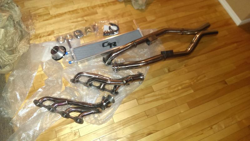

Just bought a Eurocharged stage 2 kit. Any tips or tricks for smoothest install???
Hi,
I just bought the stage 2 eurocharged kit for my 2003 CL55 amg. I am going to take it to my local mechanic to install the headers. I want to try installing the supercharger pulley, heat exchanger, inter cooler pump myself.
When I take it to the mechanic for the Kleeman headers installation, I wouldn't mind letting him know any tips and tricks to make the install go smoother so I don't spend the whole day watching him f*** around with my car.
Also, if anyone has tips or "learned lessons" from the supercharger pulley, heat exchanger, and intercooler pump (latest Bosch unit) installs \ upgrades , please let me know.
By the way, I didnt order a crank pulley, just the supercharger pulley that takes the boost to around 13 psi.
Another question, Is it easier to change the engine mounts on these cars if you have the headers off anyways?
Just trying to minimize downtime and frustration during these upgrades.
Thanks

I haven't installed the kit yet, its still sitting in the living room.
I think it is supposed to add 60-70 wheel HP and like 80 lb/ft of torque to the wheels???
I will report back on results after the install...

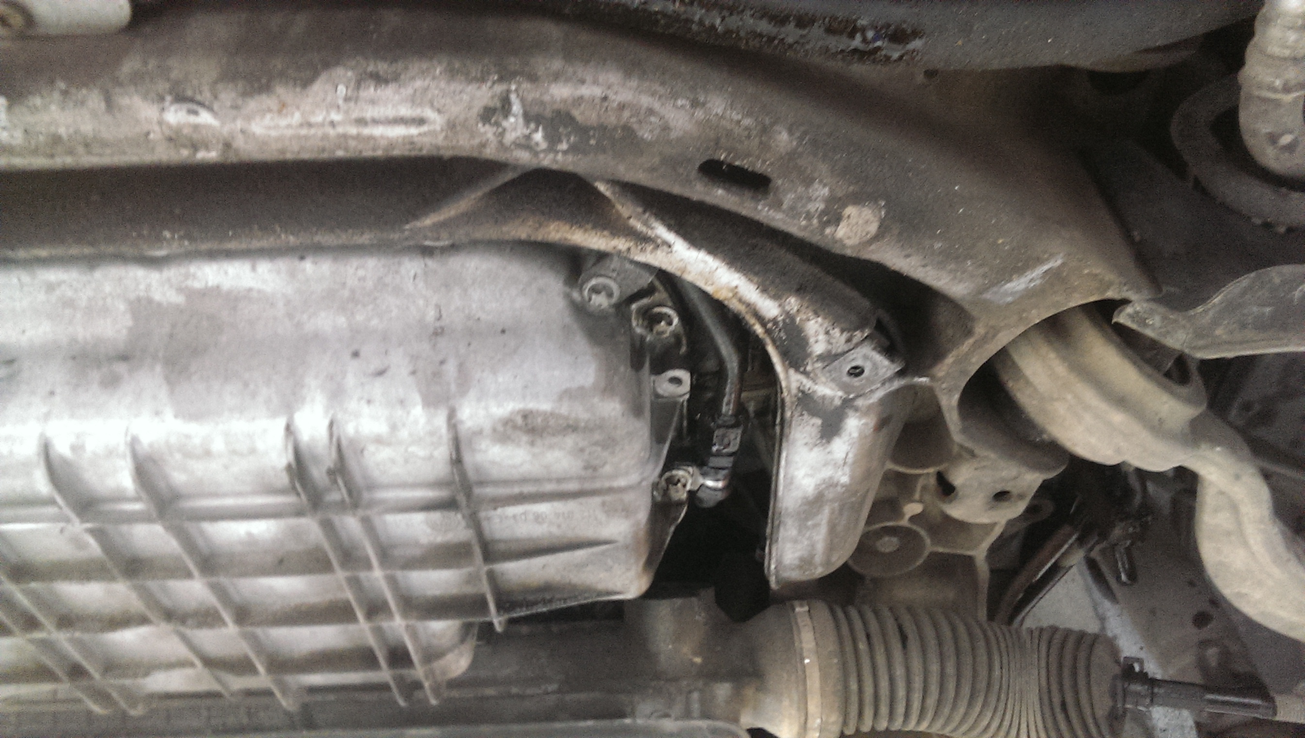

So I got the car on the hoist. Before the upgrades began:
I thought I had to replace the voltage regulator because I was getting a battery charge warning on the dash.I couldn't get the regulator off because of one of the Phillips screws ended up getting stripped. So decided to take the alternator out and get it rebuilt since the alternator didn't seem like it was in too great of shape. Removing the alternator wasn't too bad but you have to remove the cooling fan to get it out. While I was underneath the car I noticed a couple of leaks, and it smelt a little like hydraulic fluid and it looks like ABC hydraulic lines that are leaking and sweating near the ABC pump.
Attached Thumbnails Just bought a Eurocharged stage 2 kit. Any tips or tricks for smoothest install???-imag0127.jpg

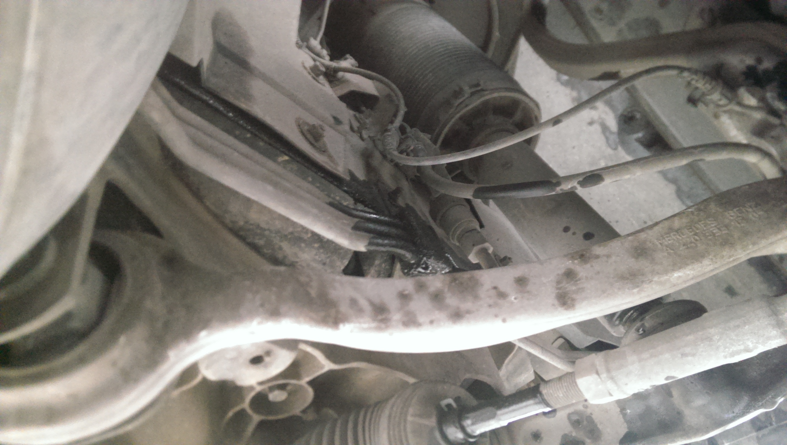

This picture is of one of the leaks near the front left (drivers) side suspension. Seems to be leaking near where those 3 line are held together. Any ideas?
Attached Thumbnails Just bought a Eurocharged stage 2 kit. Any tips or tricks for smoothest install???-imag0129.jpg

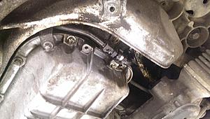

and here is what appears to be another leak on the left side of the oil pan, is this a ABC line ??
Attached Thumbnails Just bought a Eurocharged stage 2 kit. Any tips or tricks for smoothest install???-imag0128.jpg   Just bought a Eurocharged stage 2 kit. Any tips or tricks for smoothest install???-imag0131.jpg
