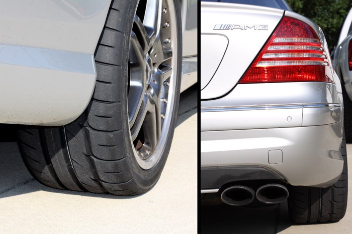

Bridgestone Potenza RE-11 in size 285/35/19 -- .6% speed difference compared to OEM size, shown on factory wheels.
You'll be hard-pressed to find a street tire that grips better than this and that won't get you killed if it rains. It's a favorite among C6 Corvette owners since they also have 19s stock. You can feel more power being put down before the traction control intervenes.
Pic is my brother's car just after tire install - please excuse the sooty exhaust tips

X2 RE-11's are an incredible tire. They are quiet, comfortable, grip great both wet and dry. They will have flat spots when you take off after the car sits for a few hours but it smooths out in a mile or two. I just wish they made them in 20"
