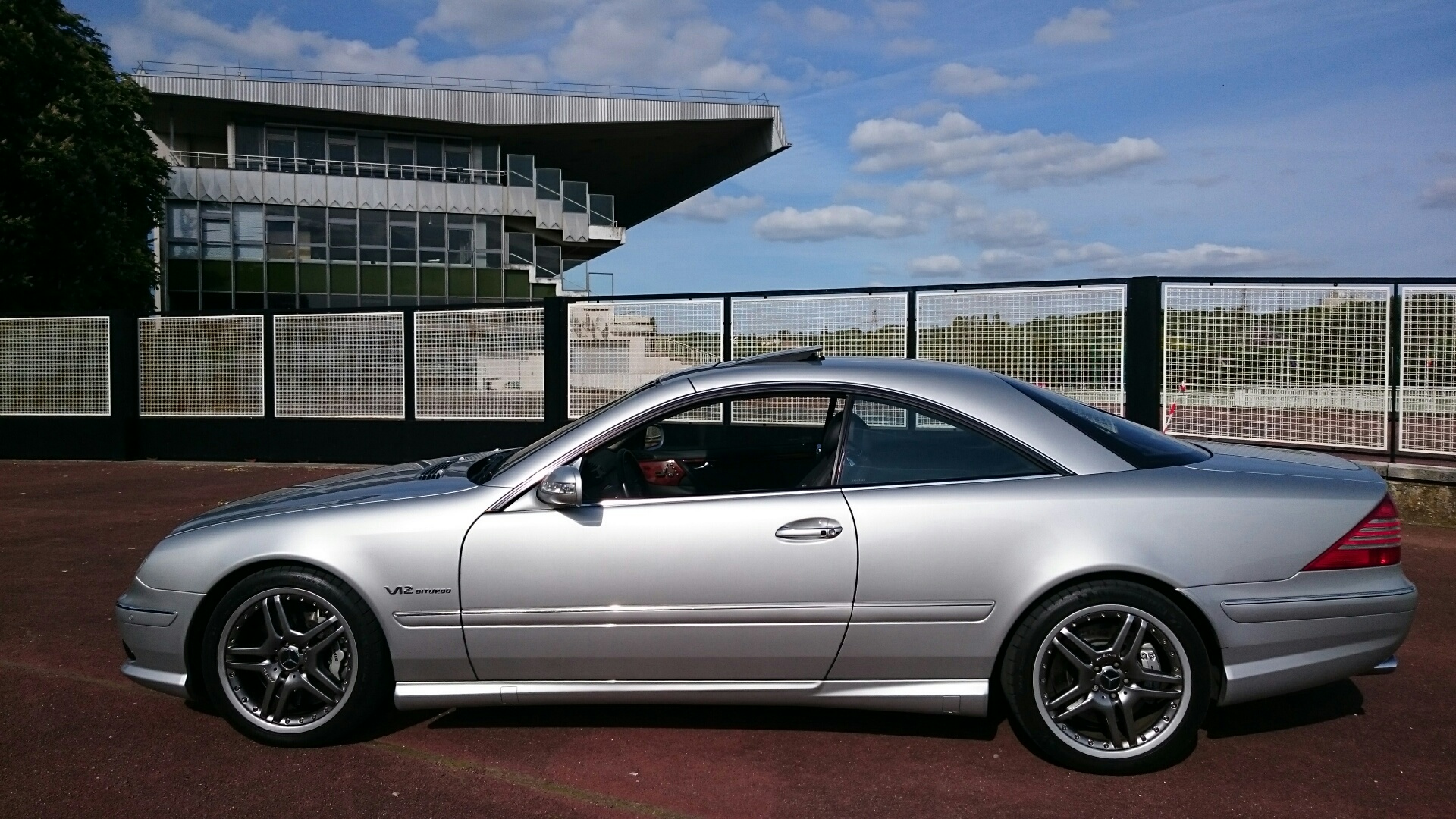

And this CL 65 AMG... WHAT A CAR
Attached Thumbnails '05 CL 65 : stay stock or tune 641 bhp & 811 ft-lbs ?-cl654.jpg
