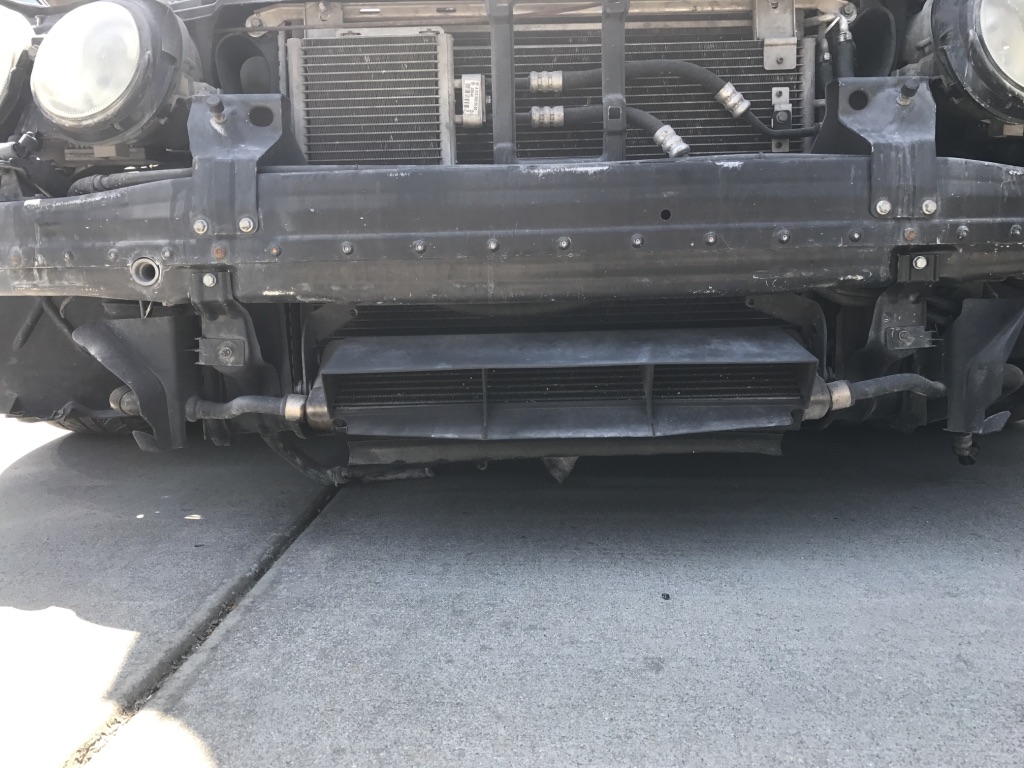

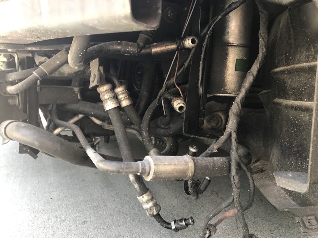

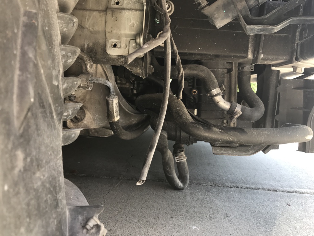

What parts are missing in these pics?
I doing some work on the car and I don't have any engine diagrams or WIS or DAS at this time. Would anyone be able to tell me what missing parts would go there? See pics.
On the front drivers side, it looks like the thats where the ABC pump would be. Is that correct?
On the passenger side, I see hoses that have been cut and a space for something where that gold hole is supposed to go.
Also the radiator return hose is dragging on the ground. How would that be that held up?
Thanks in advance.
Ather

First picture, you're missing the front valve bock - the whole assembly including the frame. Same part as any contemporary CL55, Cl600, S55 or CL600 or S65
Second picture you're missing the secondary engine radiator. You can probably do without that if the hoses are capped off, but again it's the same as CL600, S600 or S65
The auxiliary electric water pump is also missing - there's just a joining pipe in there. Needs a pump and a bracket.
Third picture, the hose that's hanging is probably the aux radiator hose, but it's not clear.
The engine inlet hoses are shared with the 600's.
All those things are readily available on ebay.
If the ABC pump is missing it's a bigger deal, but it's not visible in the pictures. The pump sits on the front left-hand corner of the engine, above the AC compressor.
If the engine starts and idles OK (with the poly-V belt removed if need be), it would be worth keeping. If not, no.
Judging by the seller's determination to get a better price, it sounds like he thinks it's not all bad. You may yet have scored a hit there. The seized water pump worries me a bit, though. Not because they're expensive and difficult to fit, but because that may be the root cause of the sale.
Nick
