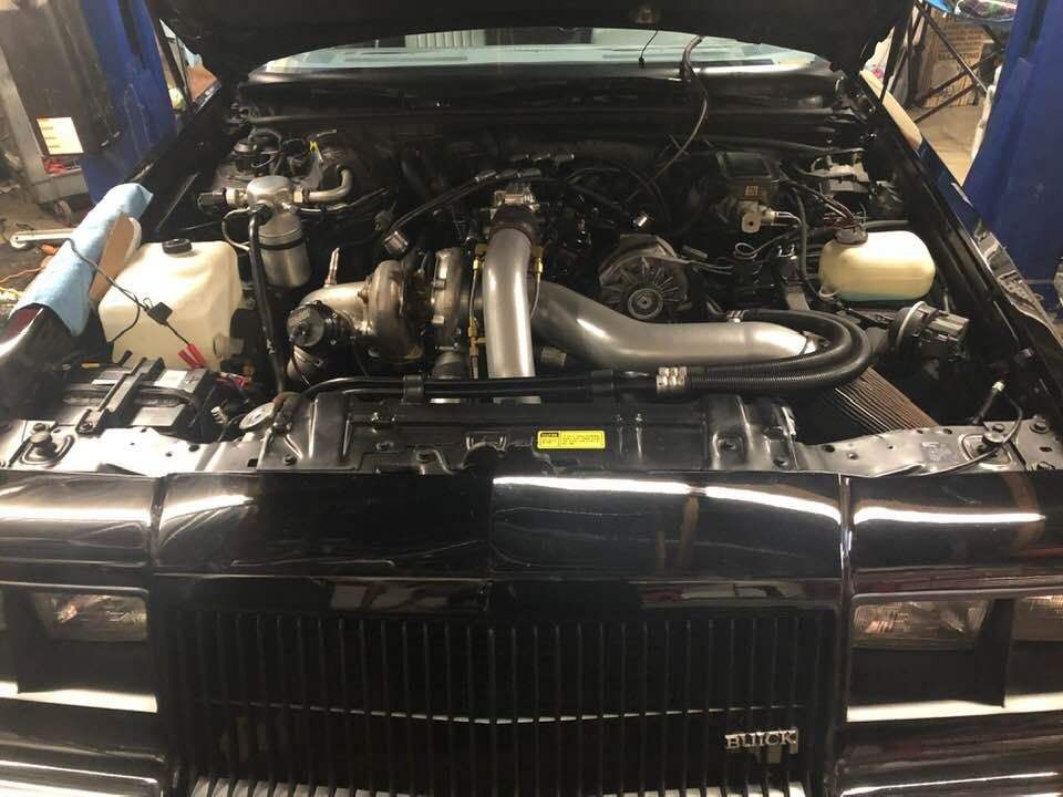

86-87 Turbo Buicks are amazing machines however they are complicated. I'm on my 4th GN and owned (2) 89' TTA's. They are more needy then the CL in different ways. Challenge is, very few people "understand" them...they require attention from a old-school wrench (I have a PRO in the Carolina area). The T-Type you are describing sounds like a possible candidate, what must be inspected is the overall rust by someone experienced with these cars..they hide there problems well. If the car is original (and in decent shape body wise...) your looking in the neighborhood of (minimum) $20K to make her a reliable 10 second car. Parts are expensive, the 2004R will need a proper build...and the almighty 3.8 will need proper build w/ support and Turbo along w/ other supporting goodies such as a FAST XFI management system. These cars are just pure NASTY when built up and well feared, along with an exhaust note that's iconic. My $.002....after GN #4, join www.turbobuick.com, find a true enthusiast that has spent a ton and is selling reasonably. You will save yourself a lot of $$ and drama. If your the type that wants to build it yourself, PM me....I have your guy.
As for pics, here's 2 basic one's. She is sleeping in the garage. This one is a 61K mile immaculate version of a GN.
