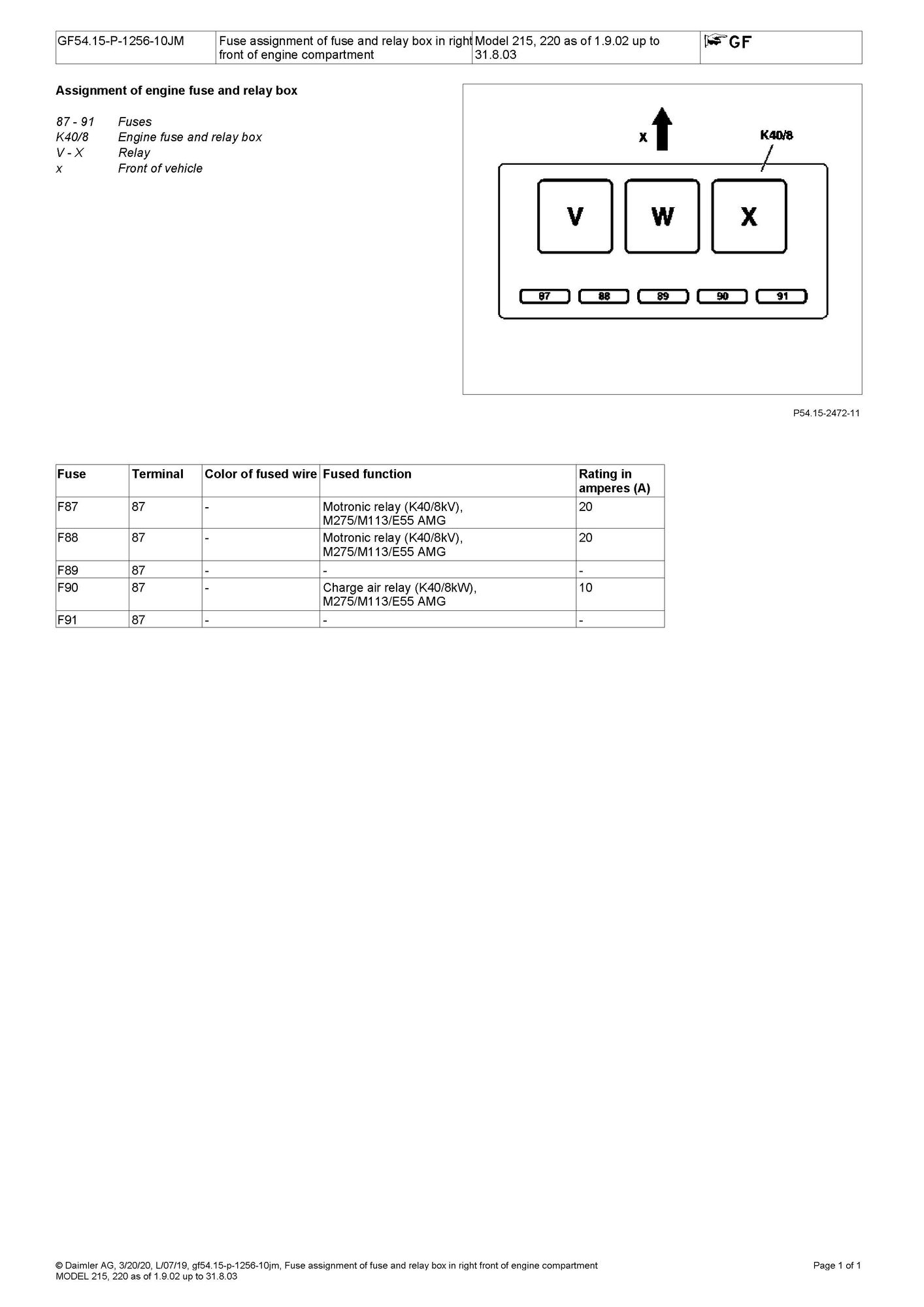

I would start with a new Carankshaft positioning sensor.

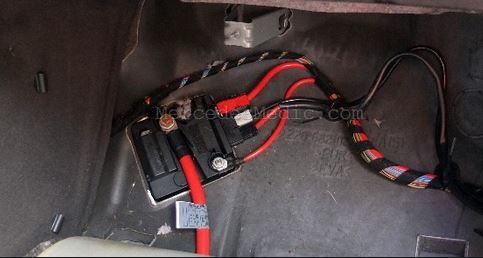

+ 2 of these giant connectors/fuses
1 under the passenger footwell
1 in the trunk

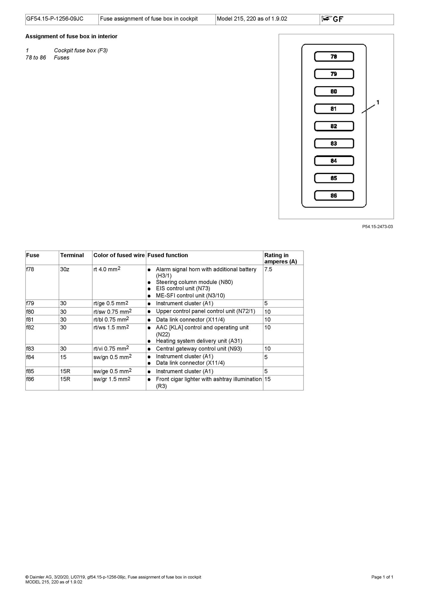

So I started checking fuses and ran into something rather unexpected. I started with the passenger side fuse boxes on the interior. The set of fuses by the dashboard were non-issues all fuses intact no problem. I pulled the panel off the rear right site and went to pull the first fuse and found standing water coming about half way up to the top of the relays along the bottom. (roughly an inch deep).
This has led me to stop looking at fuses and to ponder what this means exactly. Obviously there is a leak - somewhere - but where would a leak like this most likely be to cause water to pool underneath the rear seats? Previosuly there was a trunk leak that would occassionally cause the spare tire well to collect some water, but I there isnt any water at all in the trunk right now, so it makes me wonder where this water could be coming from.
The second question it raises - is can I just drill a drain hole through the bottom of the car to drain out the water and let it dry. Or should I try to get a wet dry vac (getting the end of the vac into the space with the fuses and relays is the challenge) and suck it out and let it dry it a few days before I try it again?
Im inclined to drill a drain hole and then just use some rubber sealant to close it back up after I figure out where the water is coming from. The more important issue right now to me is getting the vehicle running.
Finally, could this water be causing the issues im experiencing? I looked through the fuse diagram that was posted, and it explains why I dont have power to the nav / stereo system and it also explains why the passenger side door is non-responsive, but would it cause the locking of the transmission, the ecu not responding and the issue of the airmatic system not raising. That im unclear on..
