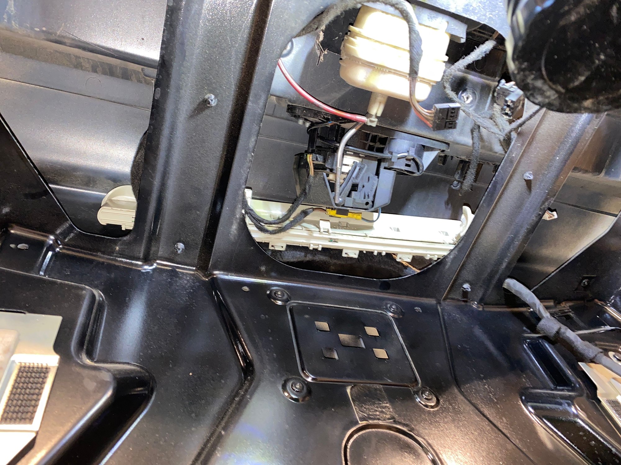

In the middle of doing a third brake light replacement, it was cracked and letting water into the trunk. I’ve taken the liner out and removed the old housing from the trunk lid but I cannot get the old clip that connects to the lights off for the life of me! And on top of that, where the light is located I can’t wrap my head around actually getting it in and out. Is there a special tool Mercedes uses to unclip these connections?

Not sure how to remove the connector, but while you're in there you should epoxy the seams of the vacuum actuator for the latch, because they generally all crack or leak eventually.
