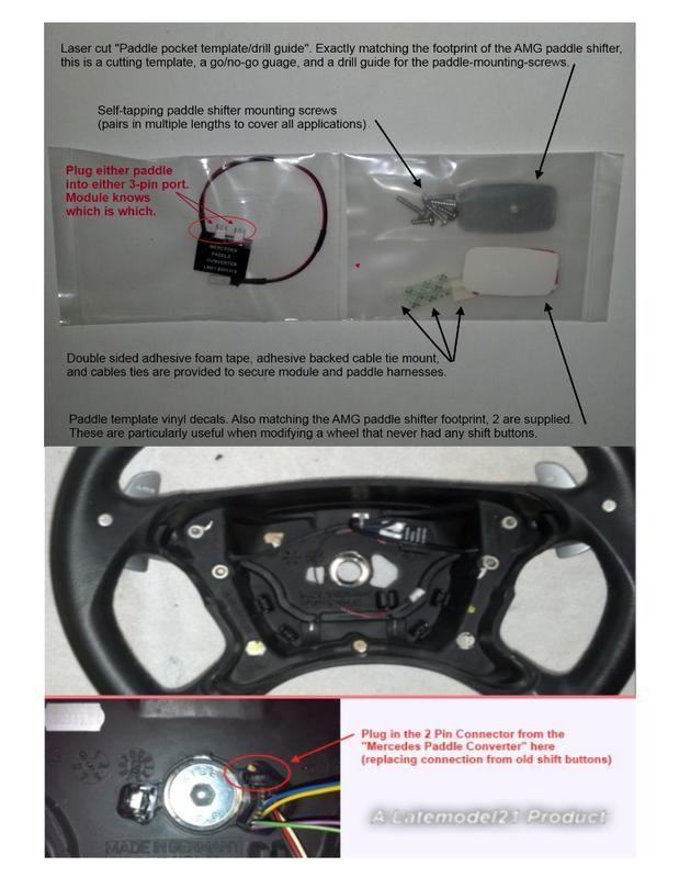

Along with RUcarbon, you can also get the module ("Mercedes Paddle Converter" module) from DCTmotorsports, or if you are in Europe contact ComandonlineUK . OR,,, you can send me a note at Latemodel21@yahoo.com if you want to get one directly or need more info (I am the designer/manufacturer). This module makes paddle shifters plug-and-play in 2003-2006 SL55/65, S55/65, CL55/65, SLR McLaren, and 2003-2004 E55 & CLK55.
