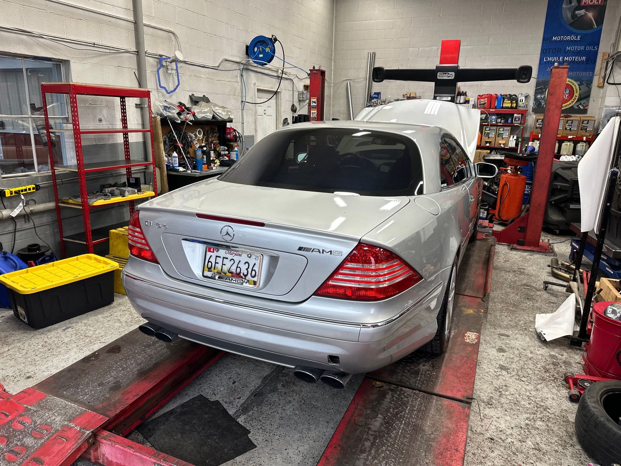

Some pictures from Phil @ VRP of the IC Delete

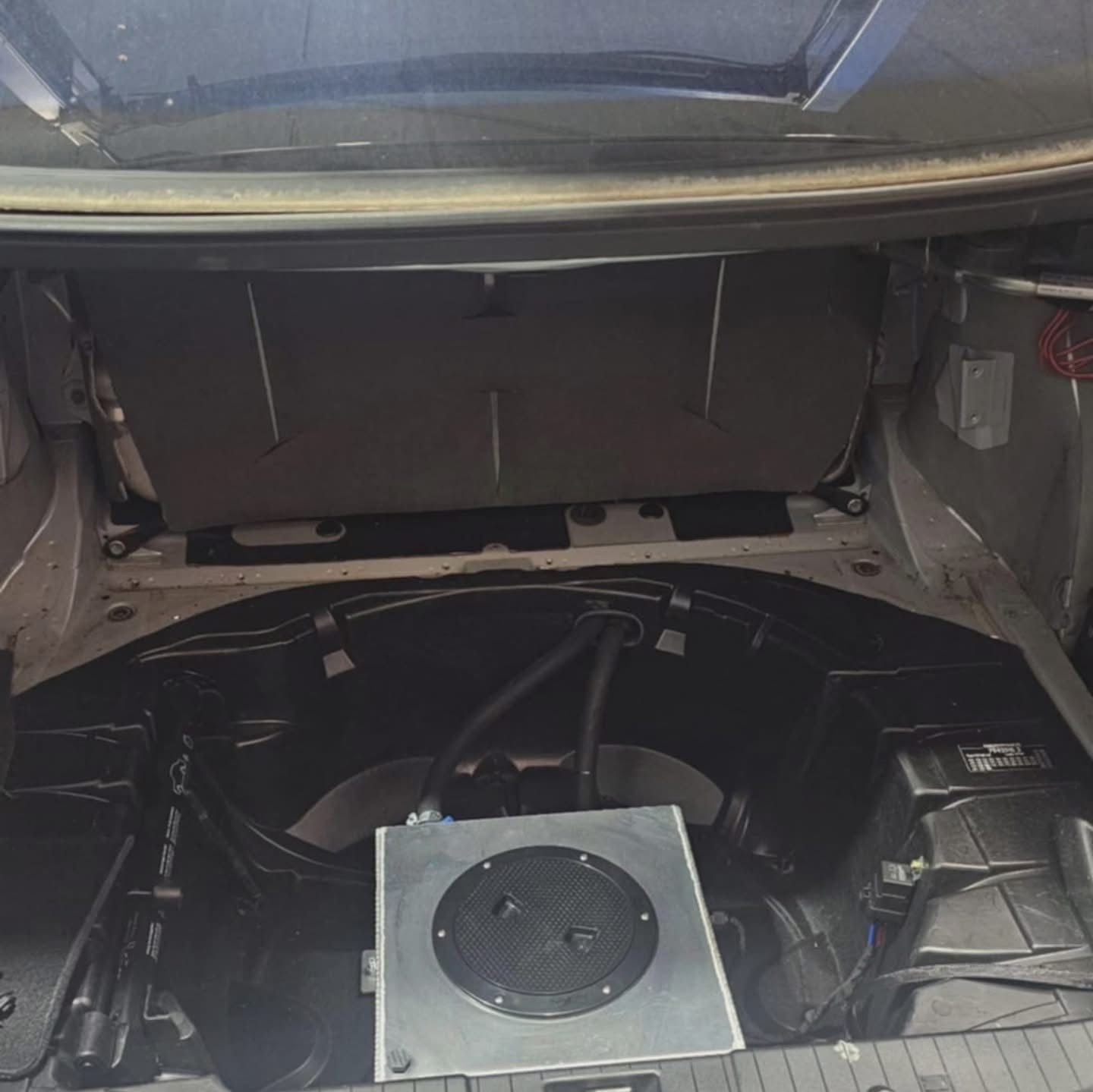

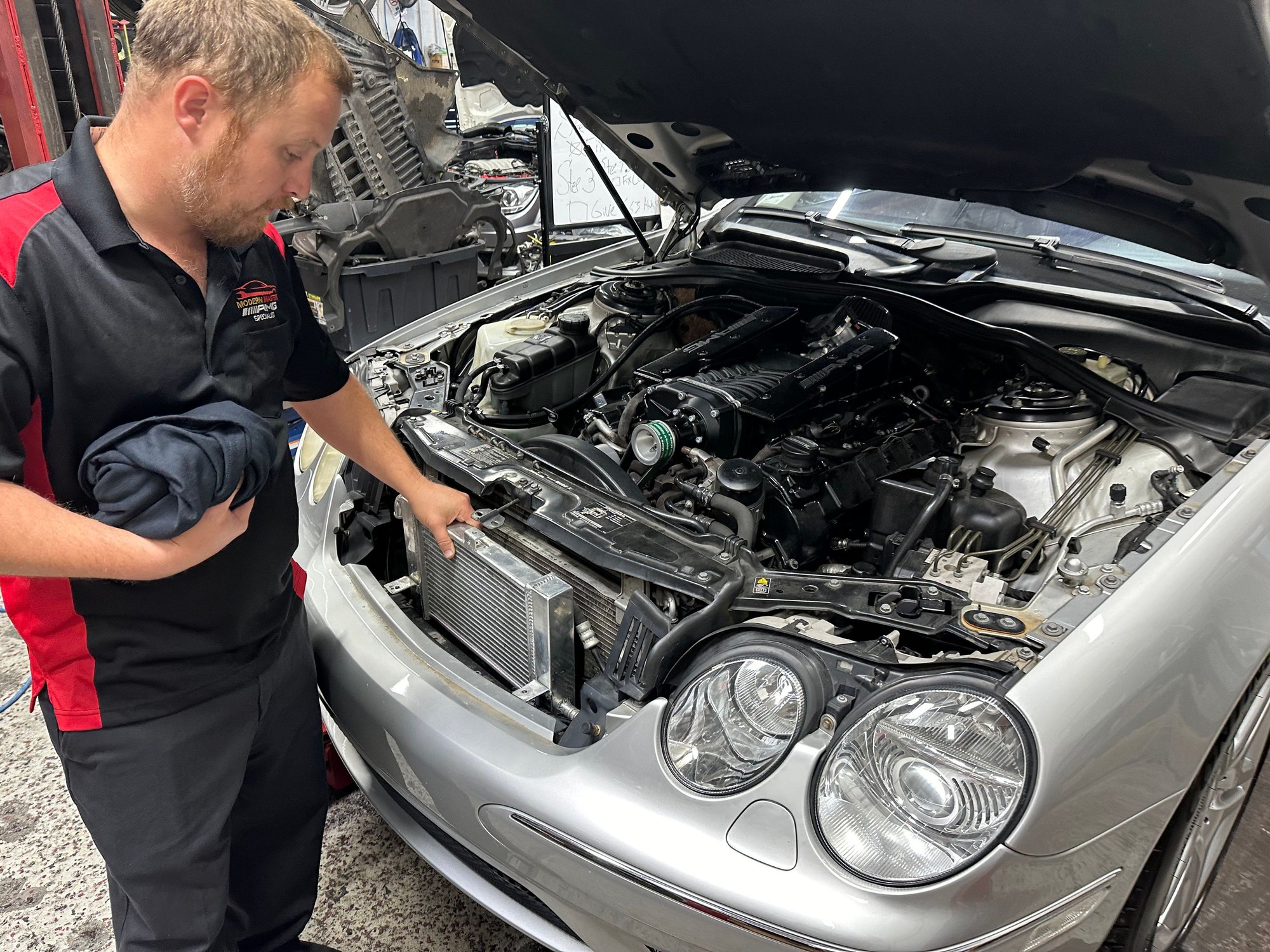

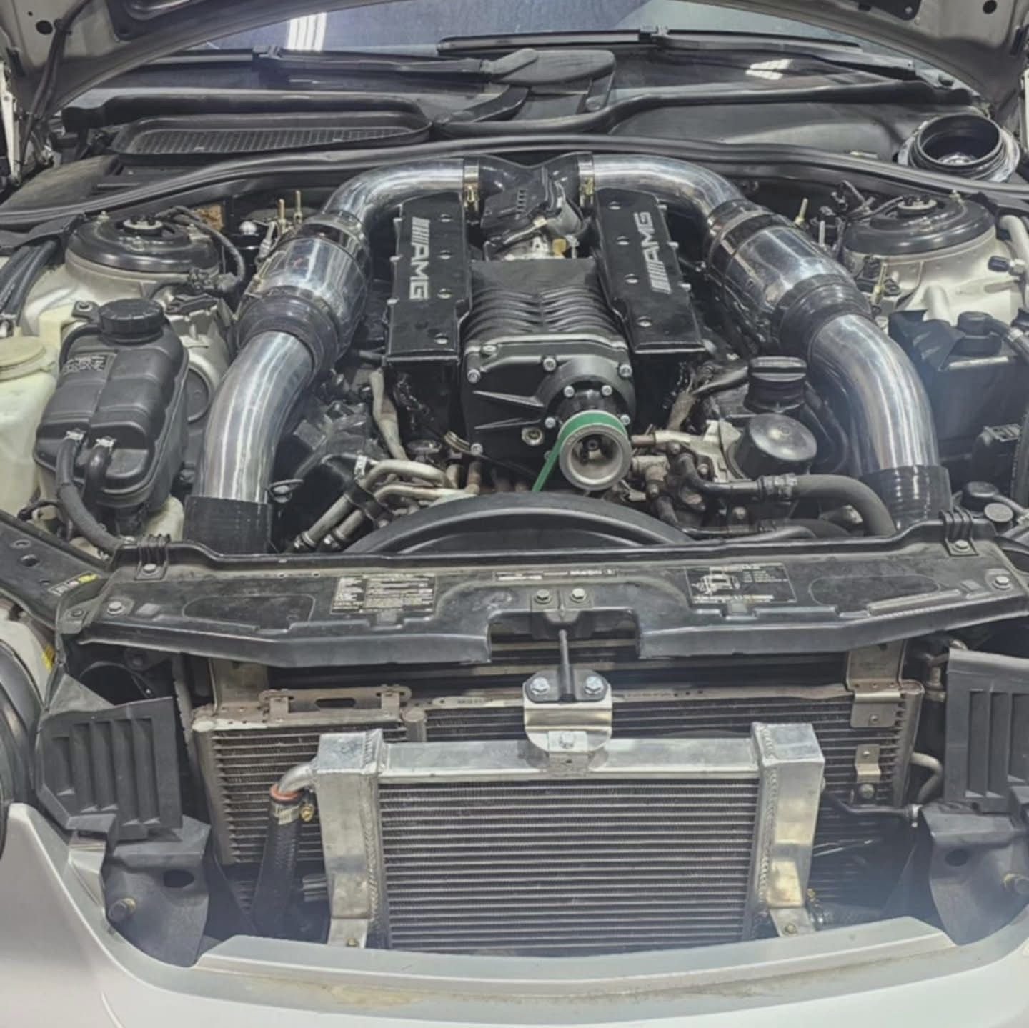

Small update!

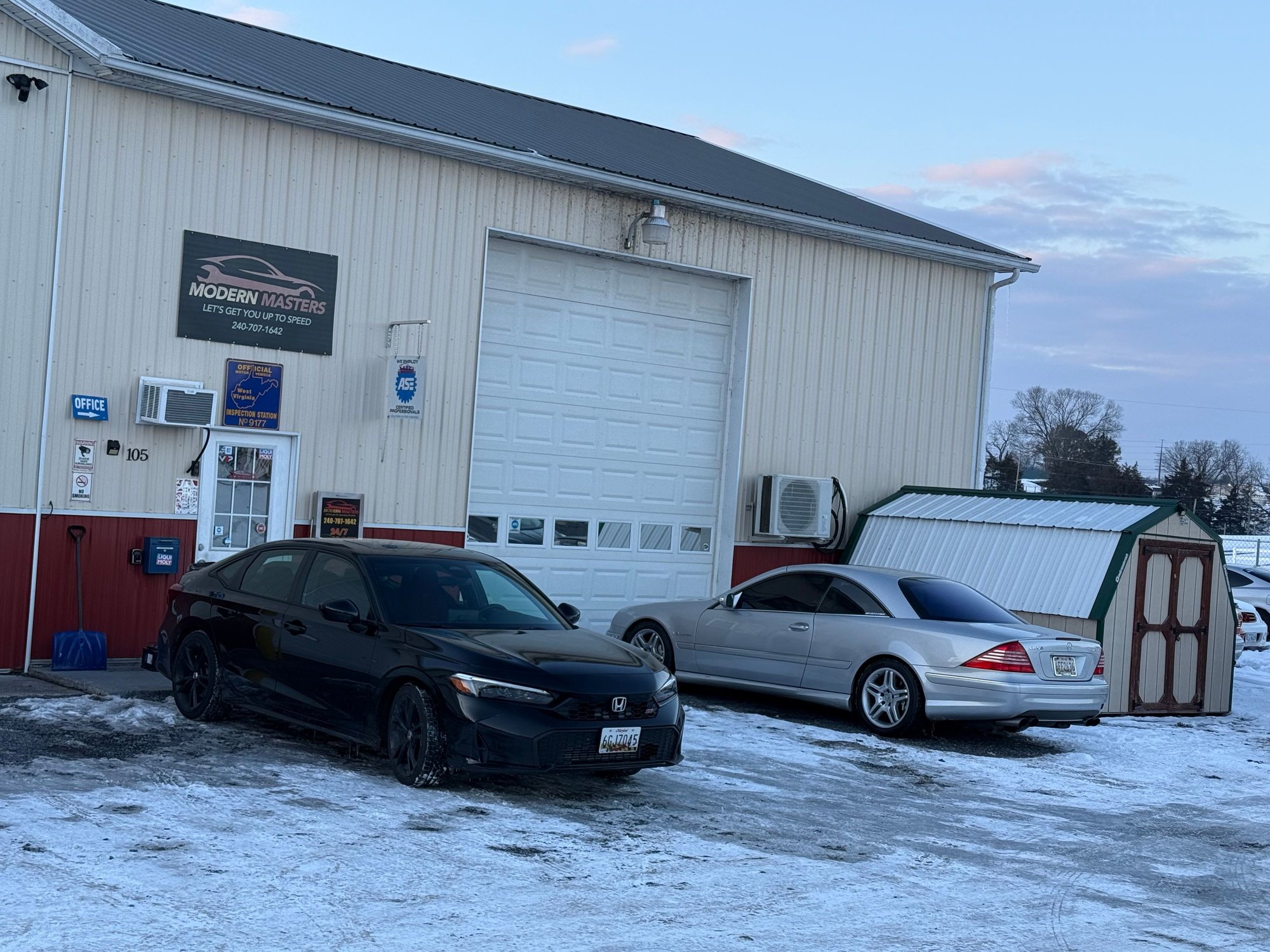

I wanted the car back before I left for vacation and the top mounts/IC delete setup was going to take way too long to receive/film etc. decided to leave it off the car.
turns out, the car isnt ready yet and im leaving for vacation tomorrow. No big deal, the car is in good hands with the guys at Modern Masters! Craig offered to store the car for me until I return, stand up guys and a great shop that Im lucky to be as close to as I am.
They have installed the whipple, working on the cooling upgrades (secondary H/E, trunk tank) and building the fuel system (1000cc Injectors, dual pumps, flex fuel). Wavetrac LSD install, datalogger, etc.
Some pics! Will post more when I receive them.
a short posted by the shop!

Been a while!!
summer vacation and family fun but back at it with updates!!
Car is almost ready! All thats left is fuel pumps, secondary heat exchanger, catch can re-routing and some minor bits.
Should be home in a week or two. Will datalog for a while then go back for dyno tune.
Flex Fuel video:
Today’s pics:
Cant wait to get her home and start driving her again.
Need to find time to install interior CF trim, replace actuators and flush suspension, and get some bluetooth in there!!

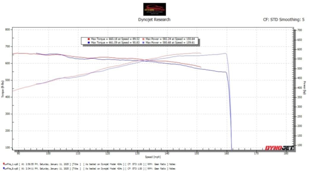

Got a call from Modern Masters!!!
Did two dyno pulls, got some numbers off the base tune from V-Tech.
waiting on the tune revision to arrive and i’ll be able to pick up the car!

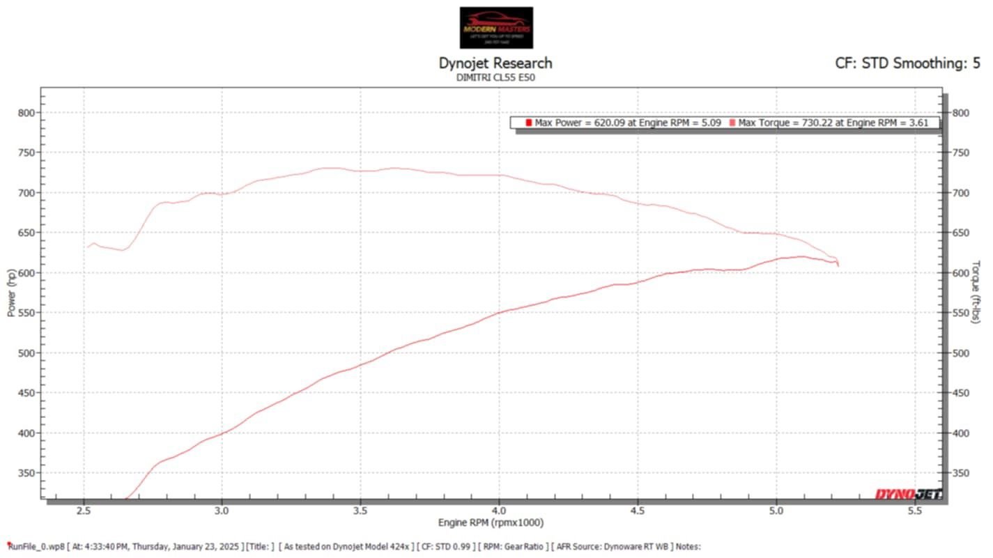

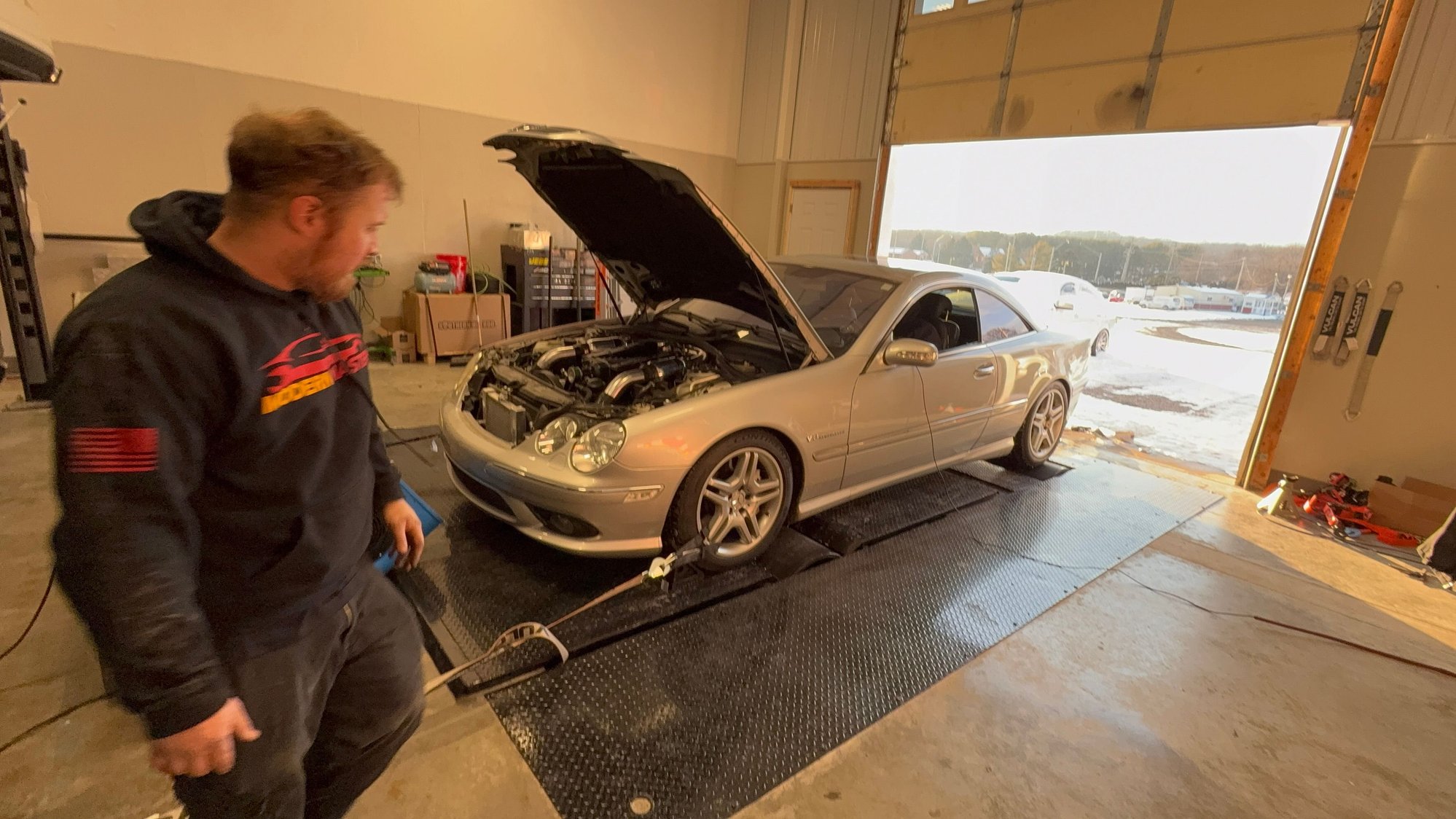

The CL is back home!

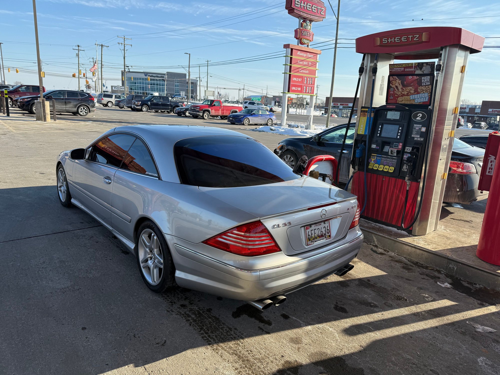

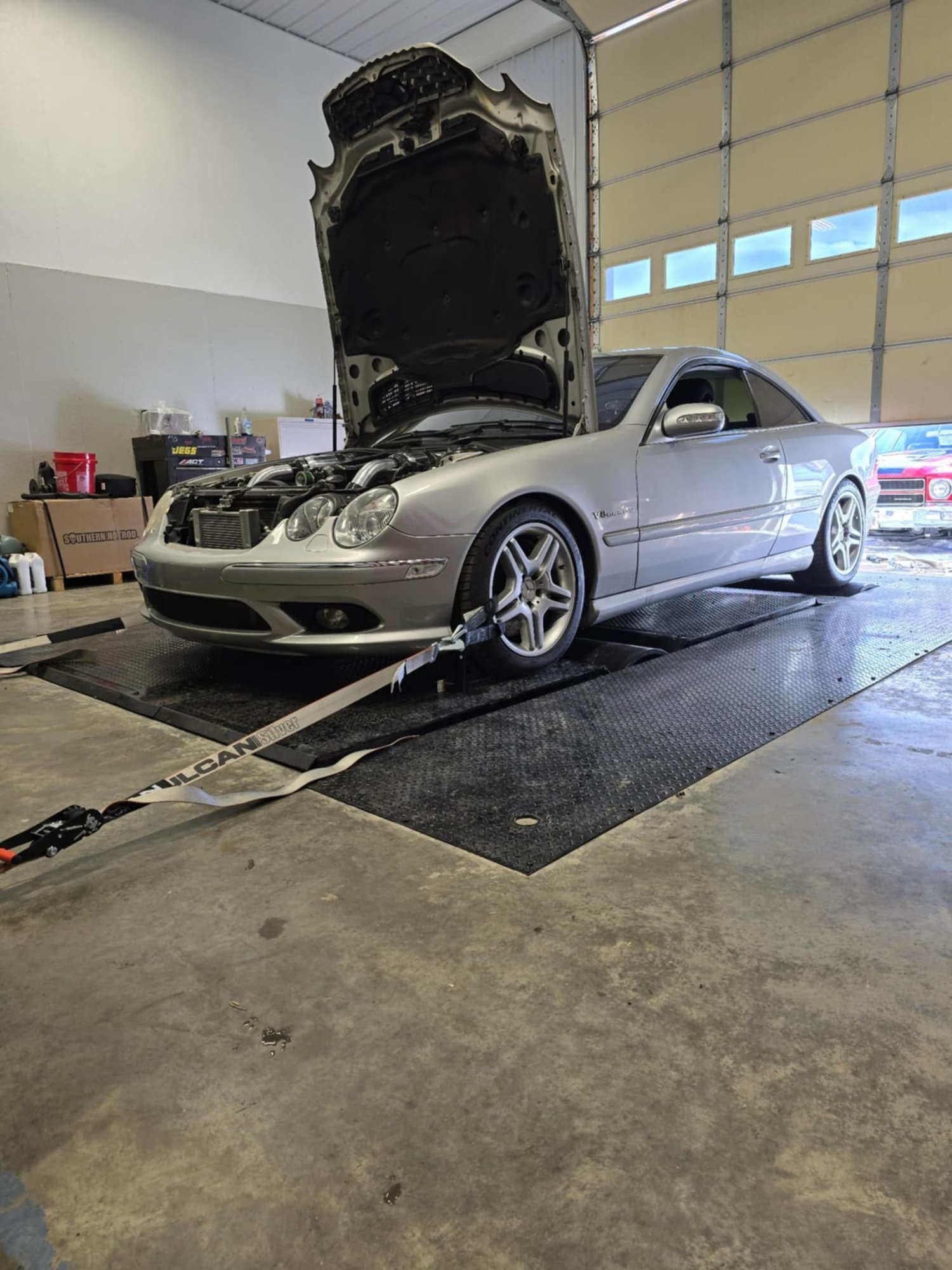

Went to Modern Masters yesterday, got to driver her for the first time with the Whipple. Amazing response, stock like driveability.
Filled the tank with E85 and put some more miles on it. First drive ever with E85. Needed time to adapt.
Got back to shop, strapped it to their dyno and:
I couldnt be happier. It will adapt some more they said but im tickled pink!
Back into daily driver duty it goes!

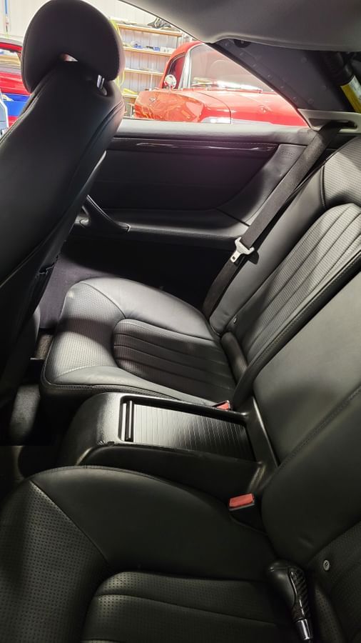

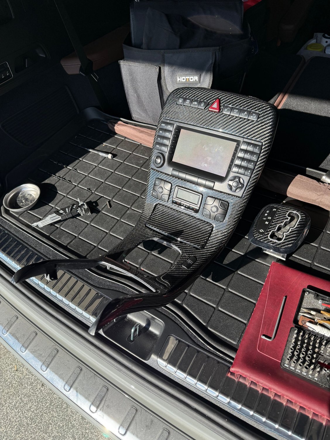

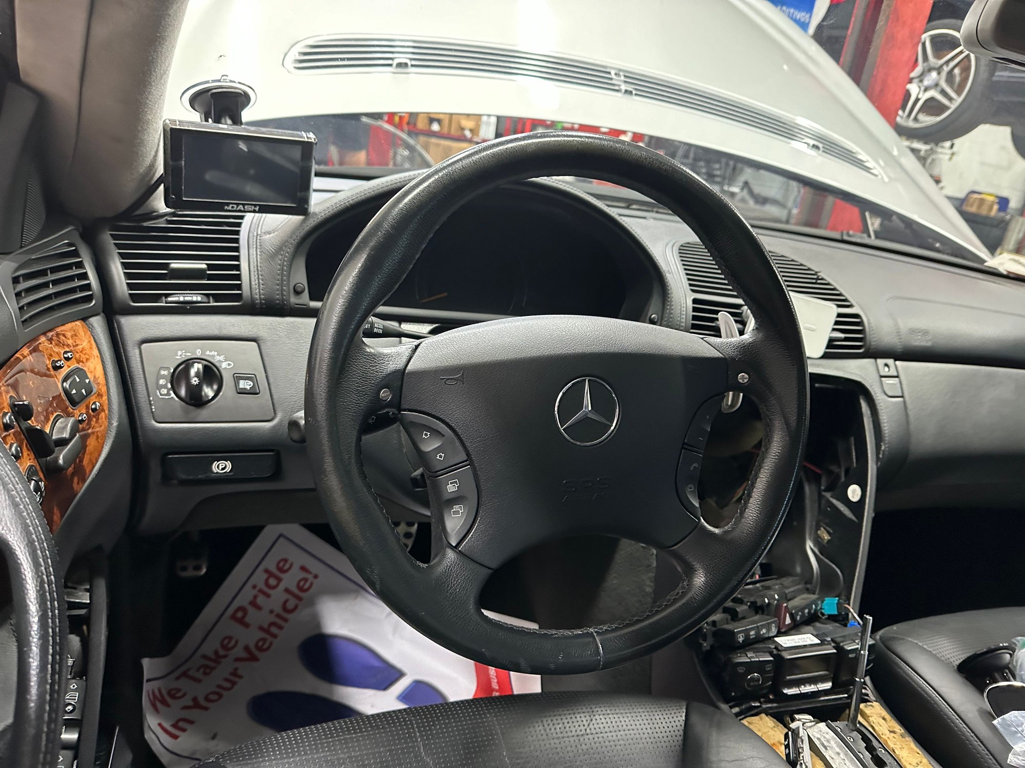

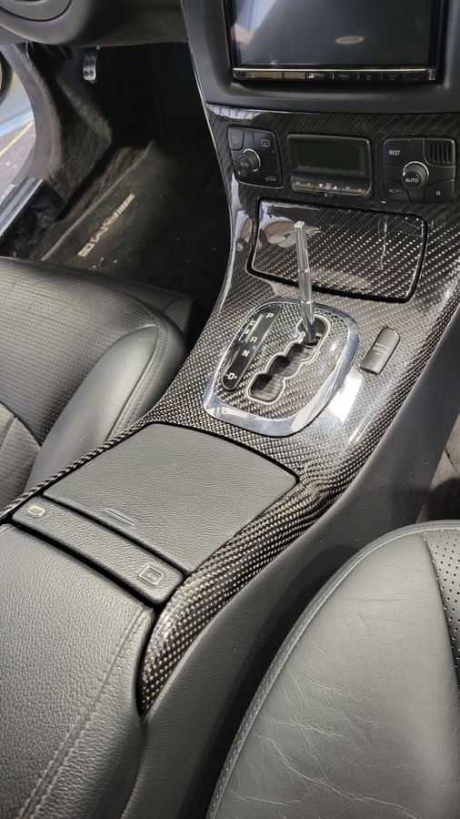

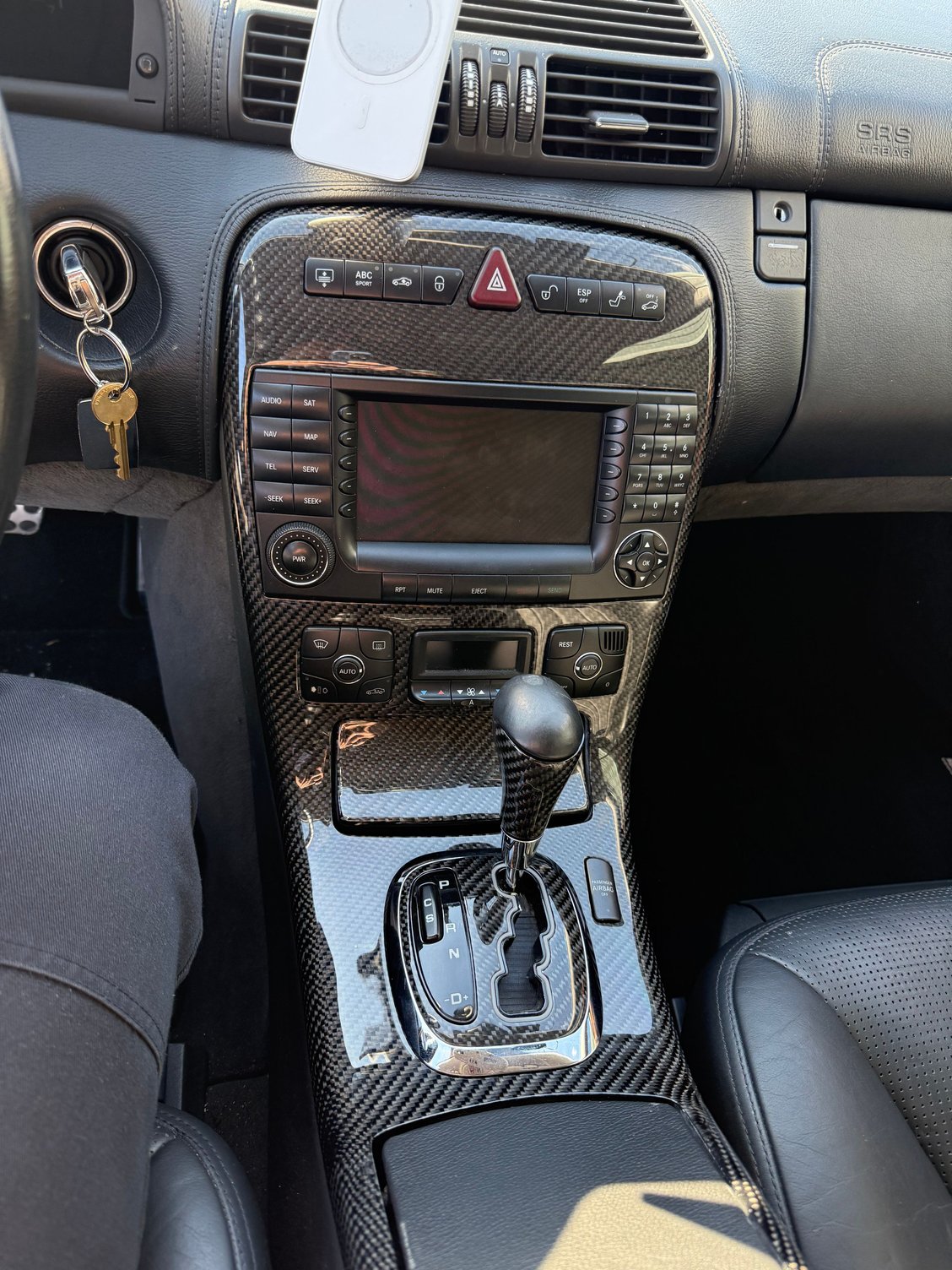

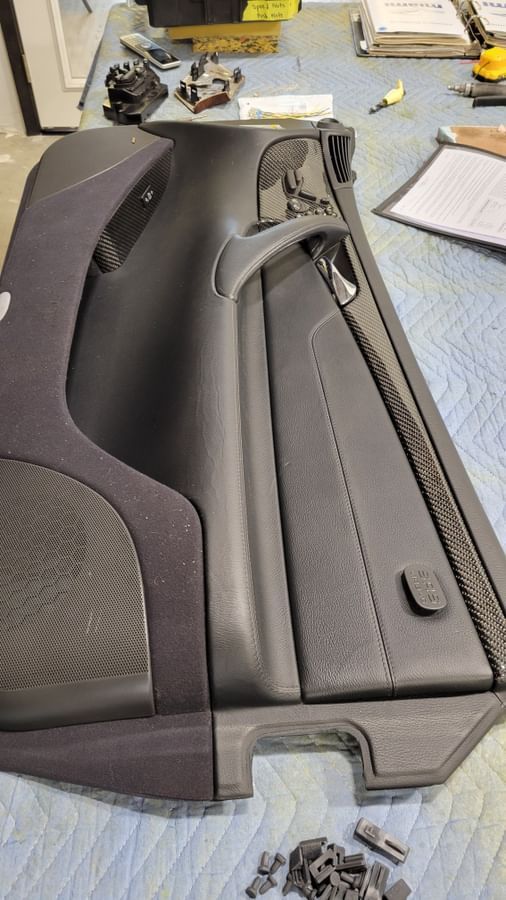

I cant believe its been over a year since the trim got home and I finally got someone to install it all.
also had a Kenwood head unit put in along with a backup camera.
super stoked!
car will head back to Modern Masters for a tune revision beginning of next month. They will also perform my suspension maintenance since Ive had those parts for over a year and havent gotten around to all that also.
at least its finally getting done? 🤣
