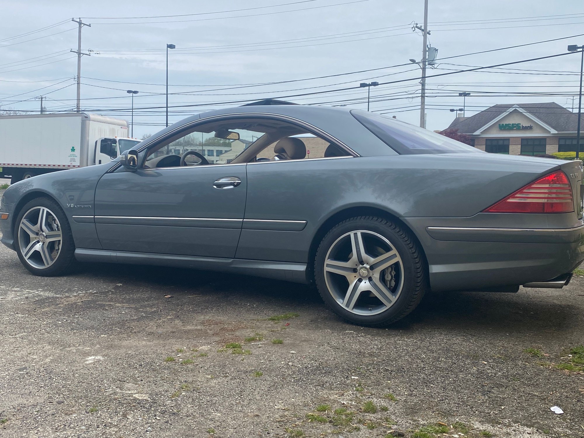

Old Nov 25, 2024 | 01:40 PM
Malone14's Avatar
Joined: May 2020
Posts: 10
2004 CL 500, 2013 Porsche Cayenne
