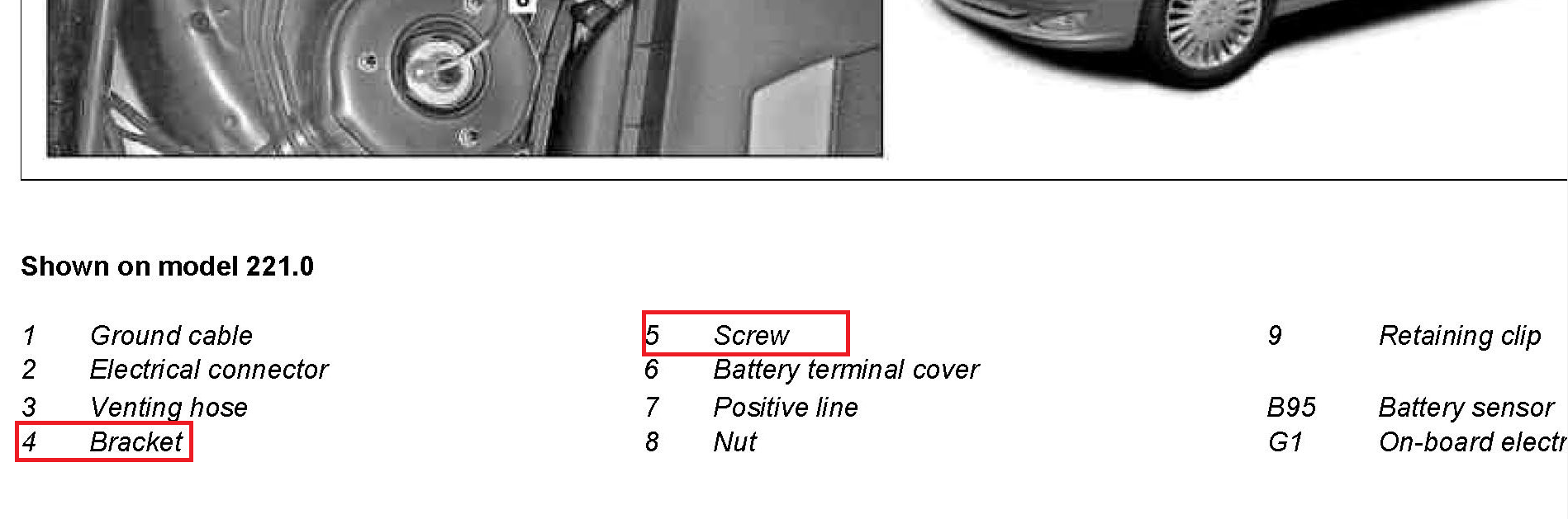

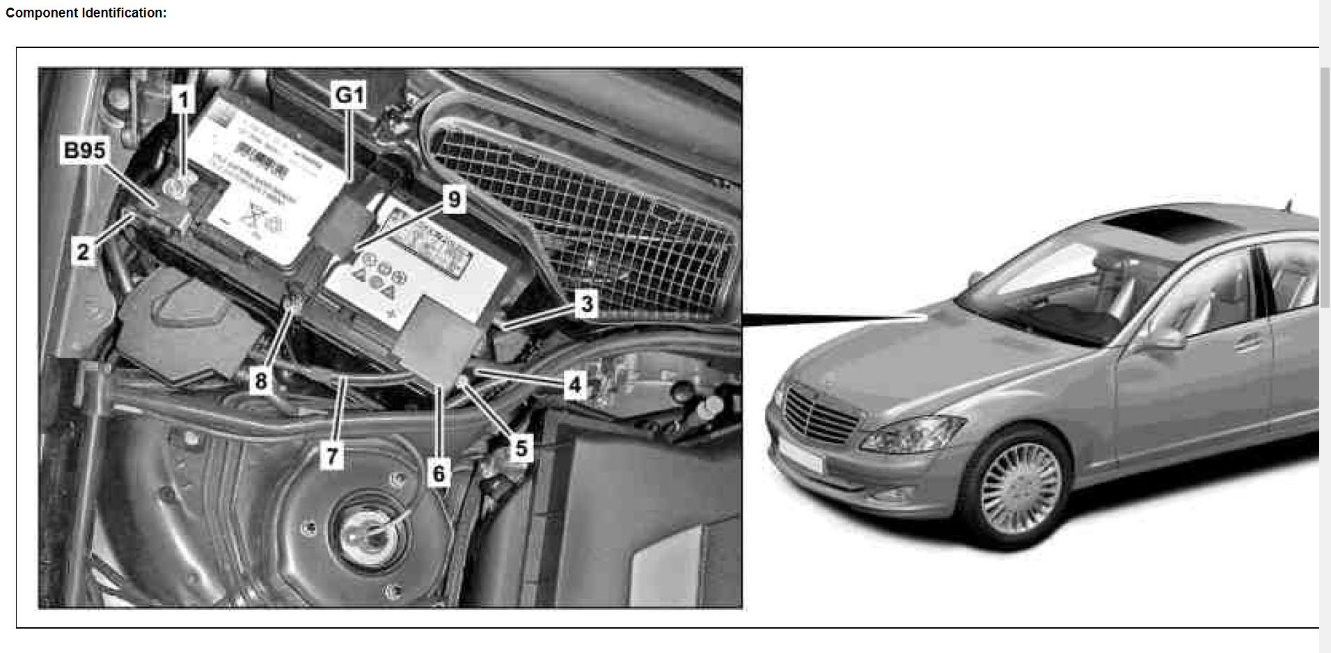

I looked up the instructions for the cl 63. Heres what it shows:
Thank you, Tim. Appreciate your time and help.

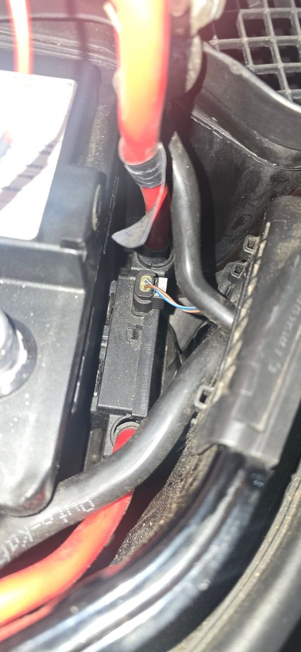

Exact same vehicle, but mine has a box on the side of the battery blocking the 13mm screw. I have not figured out how this is removed. Any advice?

Yes, that box (right side) is blocking the screw that releases the battery. Another terrible design aspect by MB. No way to reach the screw with that small box in the way. I was forced to take it to a local shop and the guy was good enough to remove the box, loosen the screw and switch out the old battery for the new one that I had purchased and brought with me. Obviously, small box must be put back in at the end.
