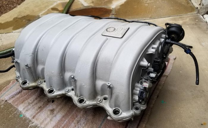

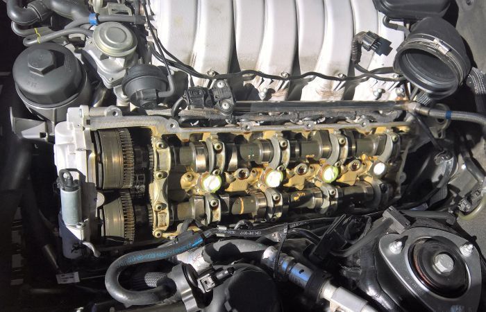

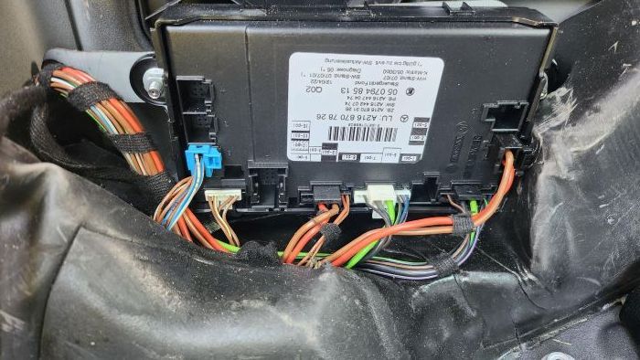

Have a 2008 with 102K miles and fix it myself. Besides normal maintenance items (belts, filters, fluids, plugs):
Motor and trans mounts
Valve cover gaskets
PCV valve
Oil filter housing gasket
Belt tensioners
Shock gaiters
Rear window control module
Brakes
ABC accumulators
Front suspension links
Rear Battery
It can be a DIY car if you have a good metric tool setup and a decent jack and stands.
