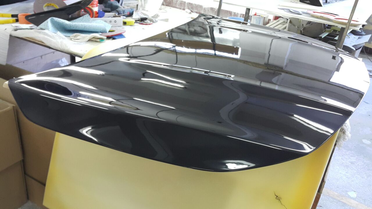

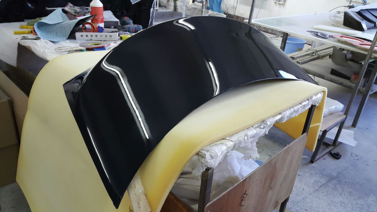

The CF hood and trunk lid were custom ordered from Smartplus here in Hong Kong and are exact copies of the OEM parts. They have been painted body colour. Now that they have the moulds, they can offer the CF parts to anyone who is interested.
Those look great. How's fitment on them compared to your OEM pieces?
