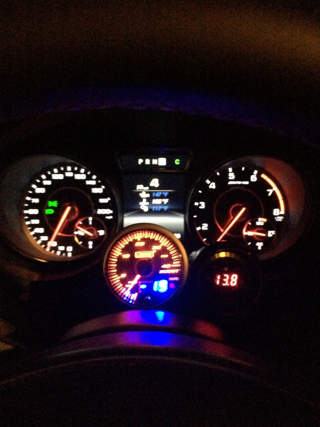

I know many here wont like this. But I do plan on making a lot of power out of this engine so at least its necessary. Helps that I like it too.
I might end up getting a smaller boost gauge and then just mounting them off to the sides of the column. Not sure yet but we will see
neat trick: I was able to install the aem gauge without using the supplied o2. didnt have to weld a new bung in or anyhting

Hey! Would you mind taking some photos of where you took the boost feed from please? I have installed a boost gauge in my A45 but need to find the boost supply.
Thanks!
you can tap into one of the lines coming off of the intake manifold. right after the throttle body
go to weistec's website and download the install instructions for the weistec bov for the cla. it has plenty of pictures. just tap into the same location they use for the bov.
Thanks for coming back to me. I don't have the Weistec BOV fitted to my car. I looked at the instructions as I can see what you mean in regards to where to T off. Any idea how with out a BOV?

How does this work via OBD for boost then.... as OBD will only see up to 1.55bar.
Thanks
Just get some silicon vac hose and insert a T piece between that and the OEM vacuum pipe, off the back of the manifold as shown in those images Steve. Nice and easy.
Thanks
you dont need the BOV. i was just pointing you in that direction because weistec has clear pictures of where to tap into.
you tap into the same spot that weistec uses for their BOV. its all the same reference.
what you will need is a T fitting. you need to find the correct size T though since the oem hose is like 3/4 in and most boost gauges are 1/8 in.
