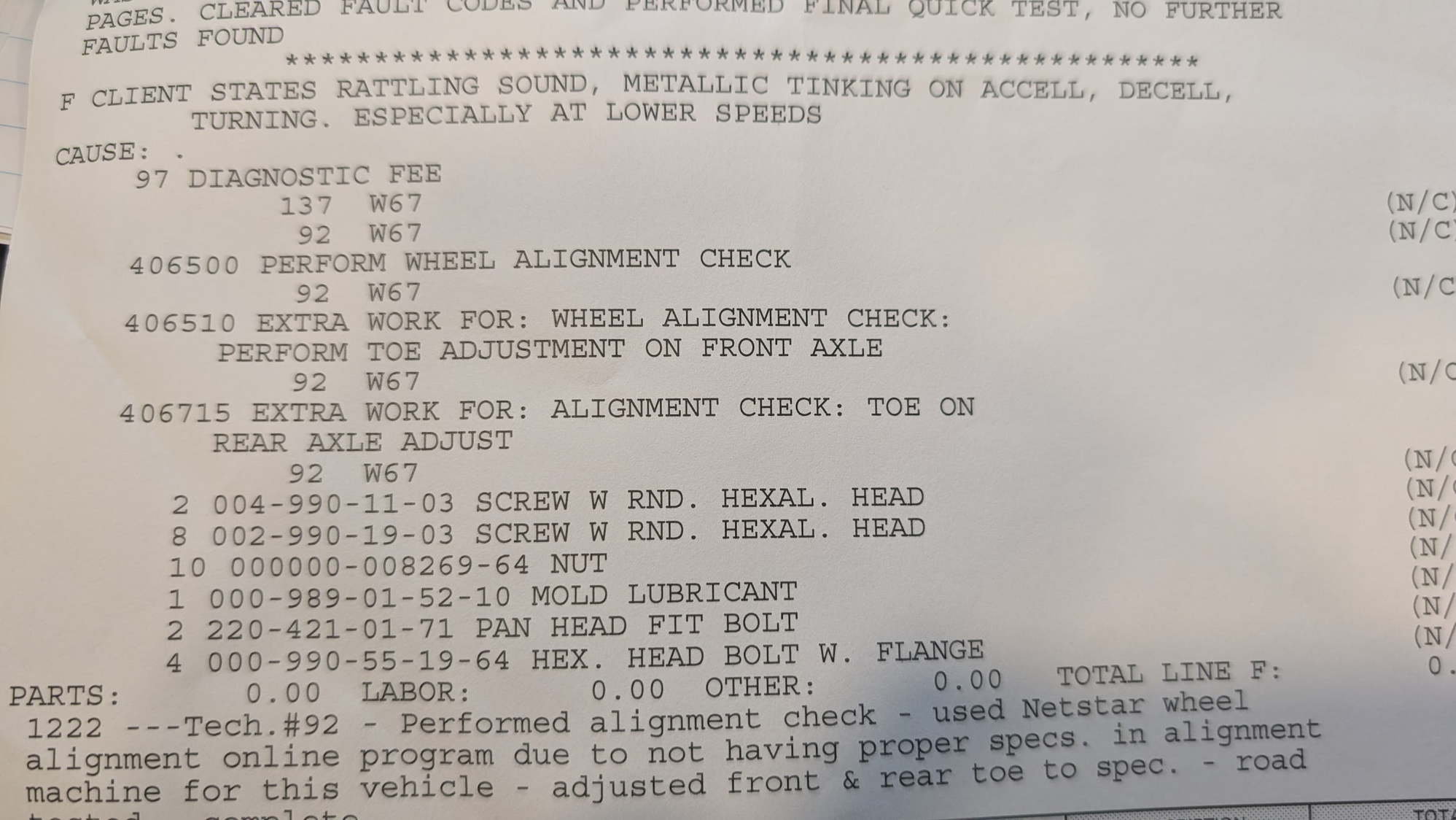

What do you mean? mine was taken to the dealer, reported and fixed months ago. Were they not able to fix it?
Old Dec 24, 2024 | 12:08 PM
  #99
Voltaire325's Avatar
Joined: May 2016
Posts: 47
Likes: 12
From: O.C. CA
2024 AMG CLE 53 Alpine Grey
Can you please share what repair they ended up making to resolve it?
Old Dec 24, 2024 | 12:22 PM
  #100
flatsick's Avatar
Joined: Jan 2020
Posts: 94
Likes: 33
From: Delaware
MK7 TDI Sportwagen, Porsche 911, CLE 53
It was mentioned that they needed to replace hardware (fasteners) in the rear hub assembly and use a different lubrication strategy. If they havent figured it out, ask the dealer to contact mercedes west chester and reference my fix.
Here are the notes, part numbers included. :
