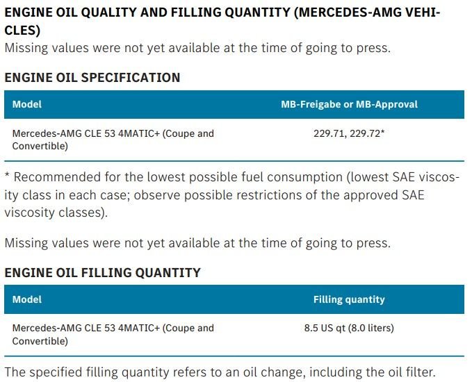

I just took delivery of a CLE 53 AMG and noticed there was no information about oil weight anywhere in the owners manual or under the hood. I plan on doing my own oil changes and would like to know the weight and capacity of the oil.

Per the owner's manual...
Mercedes-AMG CLE 53 - oil spec MB 229.71 or 229.72, 8.5 US qt (8.0 liters)
I use Mobil 1 ESP X2 Full Synthetic Motor Oil 0W-20 which meets MB 229.71

I added an oil label.

Note at the bottom of that reference :
Reference Only: Always verify specifications with your official owner's manual. Oil specs may vary by trim level and engine variant.
Mercedes-Benz specifies the use of ONLY oils meeting MB 229.71 or 229.72 both of which are 0W-20. You may "feel" that is not the correct viscosity, but the engineers who designed the engine would tell you to use the oil that the engine was designed for.
